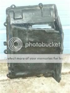

Few things done here is clearance on oil pan.After cutting and welding frame and new mounts was still to close and used a flat washer between motor and mount.Some
pics of headers and eng. fitting.Anyone who says header needs hammered I would say never seen it because there is zero clearance with hedmen 68090 on 1 tube.Have 9 inches for starter to fit.Not the best welder but no leaks.Next will be rockers and valve cover to use wipers.
