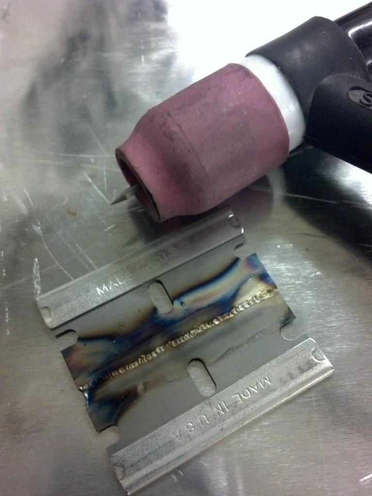

a good example of the precision possible with practice and a good tig welder
grumpyvette is online now   Reply w/quote

Im often asked why I prefer the TIG and oxy-acetolene torch welding over arc and mig for most jobs and the reasons that with both those types of equipment you can heat, reheat or adjust the heat nearly instantly with or without adding filler rod material.
that might not sound like a huge advantage, but trust me here its critical at times
