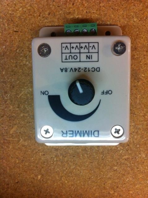

Can you dim an LED? They use such a small amount of current to operate, I always thought they were an on or off deal. Never tried though...............

If I am not mistaken led are pretty much off or on, but you can dim them a bit by adding more resistance in line. I am looking into a pulse width modulation dimmer for them. I have found some but not exactly what I want.
I keep seeing this one..
Amazon Amazon
Anyone know if I am on the right track here or have suggestions?
http://www.amazon.com/LEDwholesalers.../dp/B003L4KKF2
I think you are on the right track.

dimming the LED's
I found a cheap PWM box on eBay that will control my LED's for about ten bucks with shipping.
I took it apart and as I was hoping, it looks like I can take the pot' out of the box, extend the wires a bit, and mount the knob in a good location with the box hidden.
The box seems to work well from full down to nothing so I should be able to make it work. (Click below for really bad video)
I may wind up painting the inside ring of the bezel a flat black so it does not get the glowing ring around it, although it is not nearly as bad as it looks in the video.

Brent, concerning your dimmer, I'm on the same very path.
But I've found something quiet annoying.
Ok, at least on my dimmer, it has the exact same same casing, but the board inside has a different layout (but same design as far I can see).
On my dimmer, if you look at the back at the board you can see the two V+ connected. That means it's a sink design, shutting on/off the V- side of the circuit.
This means you can't use the ground of the car and need to wire V+ and V- down to each led.
Is that what you're doing?
I'm looking into making my own dimmer that could work with the car common ground and keep most of stock harness.

Wow. I did not look at the board other than to take it apart and see if the pot was soldered onto the board so I could relocate the pot if I wanted to
All I did was hook it up to a 12v battery charger and try it out. If it is modulating the negative side of the charge to the leds, would that not work in the car? I don't know as much about this stuff as I would like so I am not understanding why it is a problem.
Thanks for the reply.
Maybe posting a pic of both side of your board could help checking your design is similar.
I'm gonna try today to tweak the dimmer to work on the positive side, I'll let you know.
Ok didn't work, but I've found this :
http://www.solorb.com/elect/pwm/pwm2/
See how each configuration use different switch transistor.
So we may need to replace the N-mosfets with P-mosfets.
Denpo is offline   Reply w/quote

Hey Brent, I have been studying the dimmer problem with specialists on a electronic forum.
Our problem is not simple, dimming by switching the negative side il the way to go ("low-side switching" is the term)
When doing high side switching, the switching component takes the load and heat up (don't ask me why).
It's definitely doable, but component have to be sized according to the Amp the system behind is going to draw and adequate heatsink provided. In our case (interior led lighting) this shouldn't be a problem.
So I'm talking to these guys and will try to come up will a custom board design. If it works I'll make you one, I'm pretty sure we'll find a way for you to return me the favor.
I'll let you know.
One a side note, I also learned that as soon as you mention your design is going in a car they'll just stop answering you.

Denpo: I am still not sure why the dimmers won't work the way they are. The only thing I can think of is that maybe you want to run the + side from the box to the LED and then run the - to a chassis ground. I am just going to run the pos and neg into the box and run small pos and neg wires to the LED's. It is my understanding that all of the other switching done with the LS is done on the neg side. (low side switching?)
Anyway, I am quite a ways away from installing the dash, so I think it will work out by then. After all of the time I spent on the gauges, I am thinking about going with the Dakota Digital VHX gauges. I might be selling a full set of Autometers if that happens if anyone is interested. They have fancy turn signal indicators :-)
