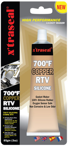

Re: looking for ideas to cure cosmetic issue
I made a few phone calls to friends with corvettes that have side pipe exhaust and asked, if they had similar issues and if they did have, what did they do about it and had they found a solution,I wanted to know what they use or if they even had that problem,
when I find a good answer to a problem I like to post it so everyone benefits
I never had that issue with my 1968 big block corvette that ran side pipes, but after asking around it seems to be a fairly common issue.
The result was that several people mentioned this product below as being very effective, you simply smear the inside of the side pipe and the outside of the collector with a thin coat and slide them together, theres only a couple thousands clearance and the silicone fills and seals the joint
http://www.ebay.com/itm/Xtraseal-Gas...abc7eb&vxp=mtr

RTV Silicon with Copper will have a pretty good hold (I use it often) and I thought you didn't want to go that way. Liquid solder wont stick to any plated metal and it will make a perfect seal and yet not stick the two pieces.
