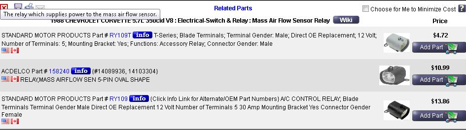

http://www.rockauto.com/catalog/raframecatalog.php
http://forum.grumpysperformance.com/...w+sensor#p9217
http://forum.grumpysperformance.com/...w+sensor#p6336
grumpyvette is online now   Reply w/quote

IIRC the MAF relays and fan relays are the same so you could pull the fan relays and swap them then start the car and see if the same symptoms are there. If gone then replace. The other way is to use a VOM and probe for output. They are fairly cheap. I usually replace all when one goes bad, Quick and easy to replace when compared to the downtime and inconvience to fix one at a time. If one goes bad then the others are usually not far behind. 20 + years on a relay isnt too bad imo.
