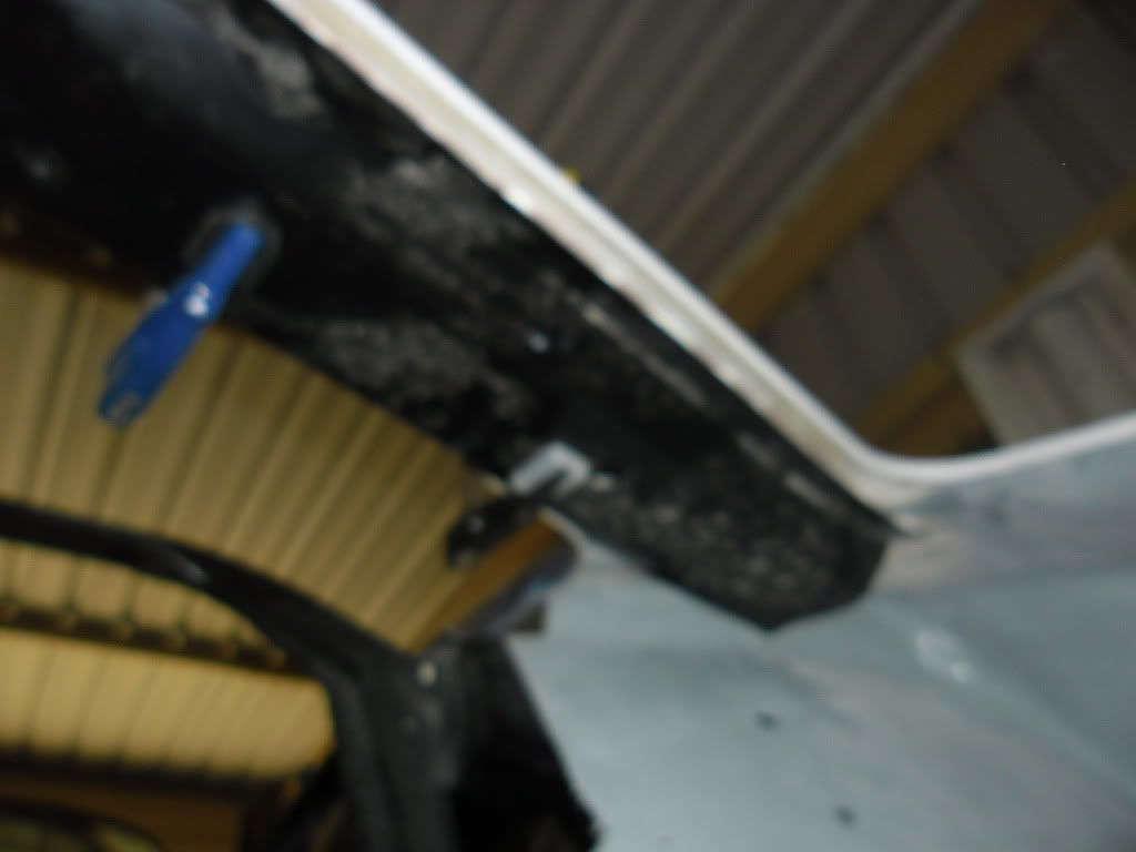

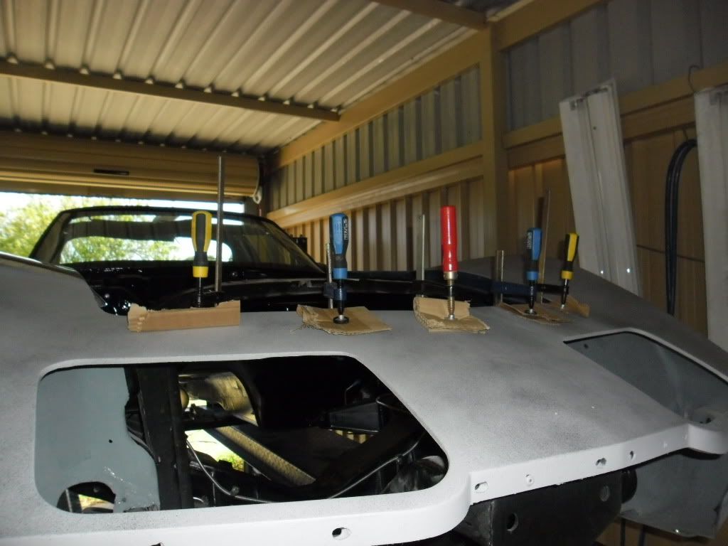

Old 01-18-2013, 11:29 PM   #7
bazza
bazza's Avatar
Posts: 40
Member #55957
Member since: Jan 2007
Location: perth western australia
1977 auto 1969 4 speed 74 no speed
i traced around where the old one was then just lined it up and clamped it ,you can see where it oozed out but its nowhere near as rough as the original job . left it for about two days if i remember rightly .
