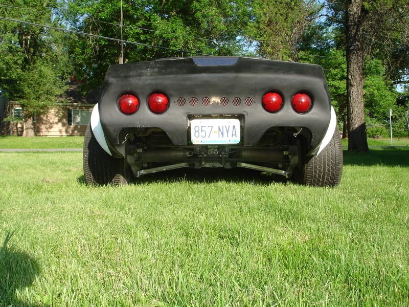

TT 1971 vert on C-4 suspension
Here ya go!
Its a stock width C-4.However the wheels are @12" wide and deepset.
