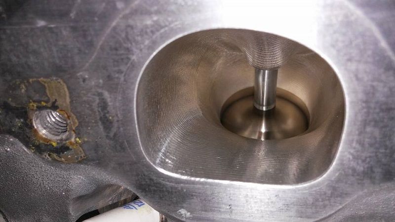

The Heads suck.
Terrible exhaust ports.

The Heads suck.
OK, OK. So one more time. just to make sure. You are saying these exhaust ports are terrible??
I need you to explain your position on this. Because I just ain't seeing it. Those exhaust ports bring a tear to my eye and I would swap them with my stock ls3 heads in a New York Minute if I could.

The Heads suck.
Can they be improved on with some hand blending. Look let's be real big dollar heads are cnc to do the rough cut the final clean up is done by hand. Why other wise would people send there brand new cnc heads out to porter. I will tell you why 20 to 40 extra hp. What is Tony Mamo's bread and butter? Porting then hand blending.
No. No they can not. They can be messed up beyond repair by hand grinding on such a precision piece. I know this is the part where you explain to me how your eye-crometer is more accurate and balanced than CNC, right?
2 ways to view Wiz.
The Intake Ports are too Big.
The Exhaust Ports are too small.
Just because it's Shiny does not mean it's right.
You use the right tool for the right job. If you have a 50+ year old engine design with a carb and some ancient magneto ignition then sure take a Dremel to your stuff and "experiment" maybe you will learn from it. You do NOT hand grind on LS engine heads. If only because of the hell it will play with the controller.
