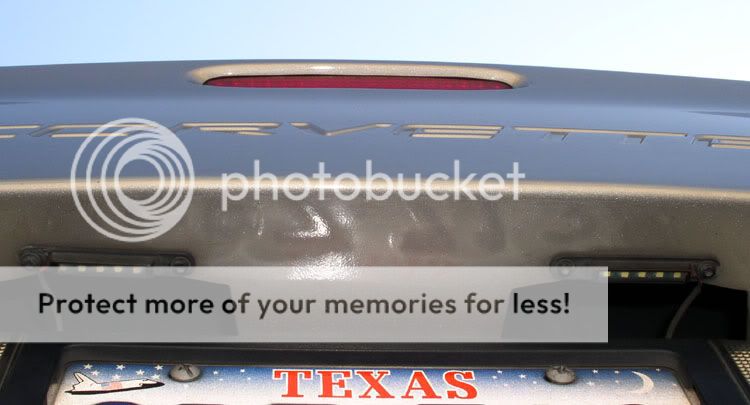

Yea, mine worked over 2 years till a few weeks ago. Oh, I forgot I added these LEDS as well. The Halo's and plate LEDS were all added at the same time. Look nice at night.

What are Muth LED turn signal mirrors? Pics?
Looks like I will buy the harness adapter to kill the hyper blink. Put a new bulb plus a touch of that continuity grease in this afternoon. Still the same problem. While I was driving it today the hyper blink was gone. Seems when my charging volts are higher it does not do it. It kinda does it when it wants

Wow, I like that mod a lot. The arrows in the mirrors are white leds? Red? My Halo's + plate leds are very bright when I hit the brakes. When I am at a red light and a car pulls up really close to me while stopped, I stand on the brake and I can see the whole insides of the car behind me. I have had a few cuss me a bit cause they cant look directly into them without hurting their eyes. Makes me laugh...
