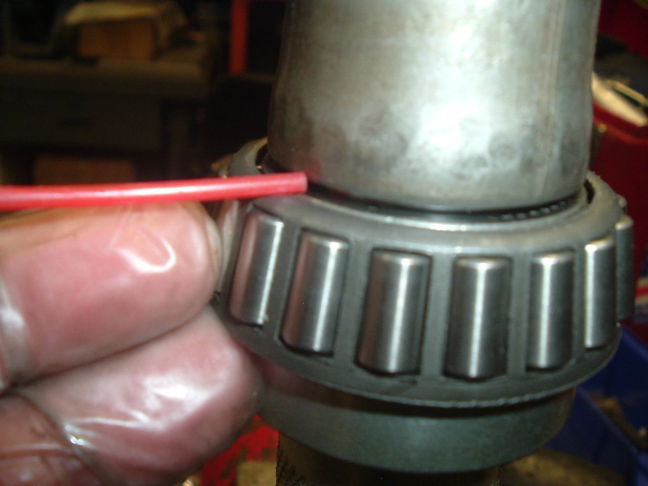

Well I found another Bubbafied part. The same arm that had the broken bracket had a hammered on spindle spacer.
I can't figure out why someone would do this, it was purposeful since the spacer is hammered 360* and the large bell end is really beat up. The spacer was probably junk when they worked on it and just made it worse. You can see the gap under the race, no way in the world someone would be able to setup the bearings with a spacer like this. I have some good used GM or new aftermarkets here to solve the problem. For those of you rebuilding your bearing be sure to check and parallel grind these otherwise you are going to have all kinds of setup issues.
I'm thinking, the reason it's hammered all the way around was to displace the metal to make it grow...that's my best guess.
