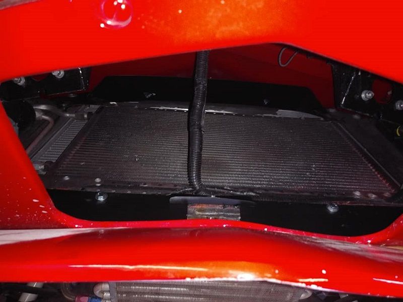

The top of the core support used to have foam that would seal around the plastic ductwork for the air intake and to the factory hood. We have a earlier BB hood and there is no foam at all on top of the core support so as air gets deflected up it just wants to continue up and go over the core support. We need to force the air to come up into the nose of the car and then turn and go back down to pass through the condenser and radiator. So I made this piece to extend the core support forward a few inches at the top..
Top view of my deflector installed..
And from underneath..
I'm guessing for weight reduction this car had it's front bumper / vacuum reservoir removed. Kinda scary but nice for airflow..

I also made and installed side pieces that can only protrude forward a few inches. But it is better than nothing. And it does a good job of promoting fresh air being drawn across the radiator and condenser instead of recirculating hot engine bay air..
I also made some changes to the trans cooler. It was mounted flat and I made some brackets and got it to mount at an angle..
From the front..
From behind the cooler looking forward..
And here is a better shot of the air dam I made to channel air up and through the cooler..
The lowest point on the cooler is 1/2" higher than the lowest point on the factory front spoiler.
