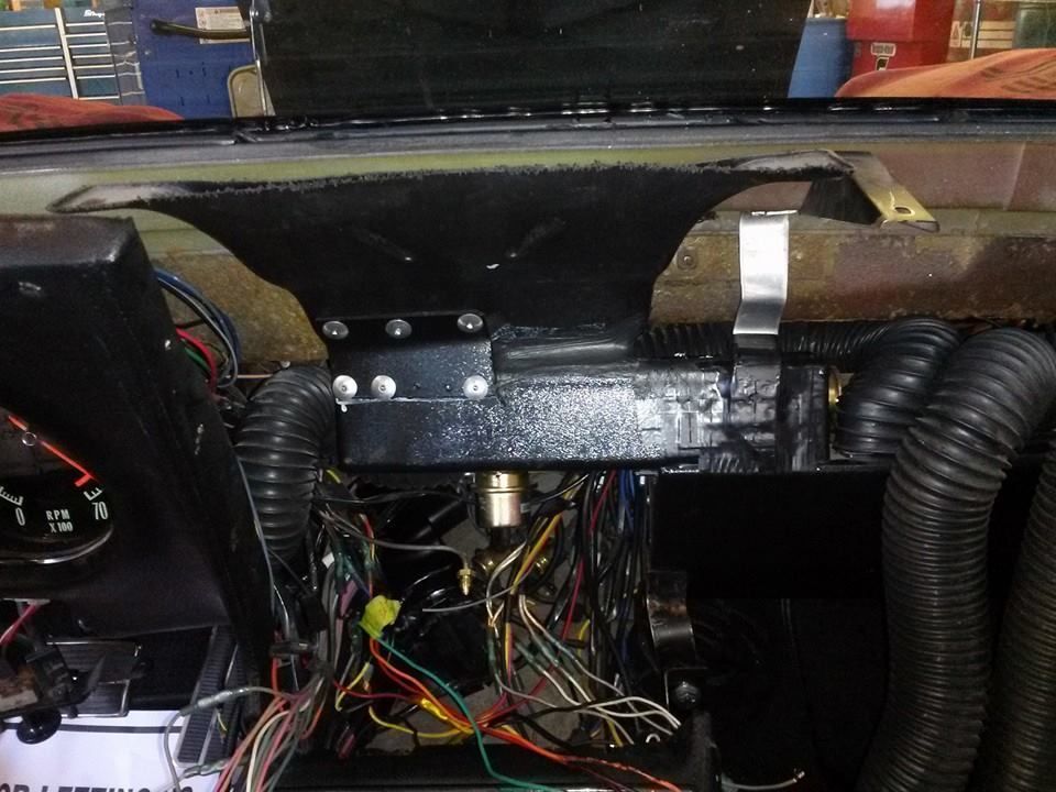

today i had to take apart the dash. the fast efi kit comes with a distributor and it does not have a tach drive. so i need to convert his tach from cable to electric.
and while i had the gauge out, i also have a stereo to install and i noticed this problem with the aftermarket air conditioning system...
can you see the huge gap between the air box and the defrost vent? or how the entire box is leaning? or how whoever installed this just slapped a few pieces of duct tape over the front of it? i made a few very crude and simple brackets and took a few rivets and some glue and some spit, and now this a/c will work properly...
still got some work to do on that rat's nest back there.
