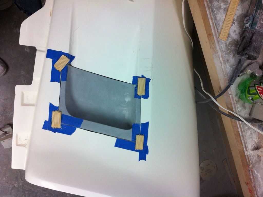

We got the new fenders in today.
I got the first pair of these. They look pretty sweet and now we wont have to modify the front to fit the 73 nose i am using. They will fin 73-79 so they would look really nice on ..say a white 74 for instance. .
I had already mounted the scoops on the other set so I cut them out again and moved them over to the new pair. I should be getting good at this by now.
I tried something different this time that worked pretty well. Taped off the corners of the opening in the fender and also the corners of the insert. I broke off some paint sticks and hot glued them to the tape. I then hot glued the insert on the corners and stuck them in place. That held it in place while I flipped it over and started glassing on the back and when I was done it popped off pretty easily and did not leave a mess..
That is all for today.
