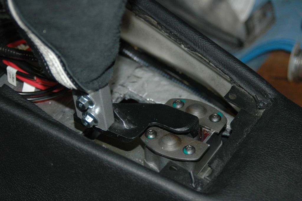

Wiring still moving along.
Check engine light works - (thanks Josh for the help).
Park brake alert light works - (modified to LED).
Shifter plate has been modified. Pot metal quality was poor. Sanded down & removed fiber optic scripts and sanded smooth. Just need to shoot it with body color.
Shifter boot was custom built. Not mounted but looks good.
Like others, custom modified shifter locator using stock parts.
Steve.

Looks really good. I'm paying close attention on the interior work for any tips/tricks. You were able to adapt the stock shift console plate to the T56 shifter position?
Neil,
Yes. The black 'diving board' shown in the photo is the modified piece I made.
The first pic shows the factory shift plate with the modified shifter installed.
If you are trying to keep the factory shifter position, modification is necessary. Otherwise, the shifter sits at the very bottom of the center console & would look out of position, IMO.
Steve
