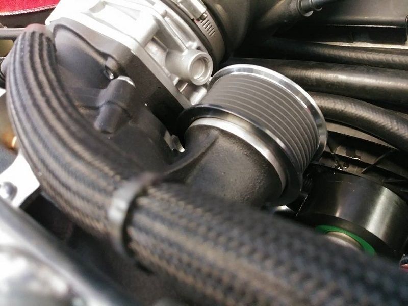

But it's not enough. We need more. We already have an over sized crank pulley and the smallest 8 rib pulley that magnuson makes for their heartbeat blower. And there is another problem with going with a smaller pulley on the blower even if we could find a smaller pulley..
I know it looks like it is but it's not actually touching. with a flashlight I can see light between the 2 and the belt is quiet and doesn't smoke. Any smaller on the blower pulley and we are going to have to do something with that water outlet.

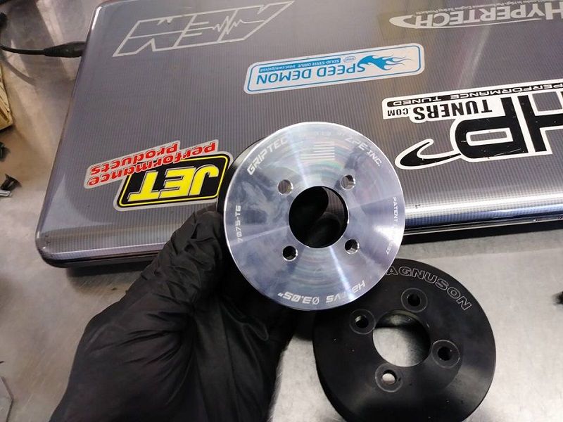

We found this company that makes the pulley we need. They had us measure the snout of the blower and assured us it would fit..
And I don't believe for a second you could fit 5 sheets of paper in there..
But it fits it spins free and it is most definitely the smallest pulley that will fit on this blower. New dyno sheet is on the way

all back together and the water outlet has moved to the other side of the water pump pulley..
