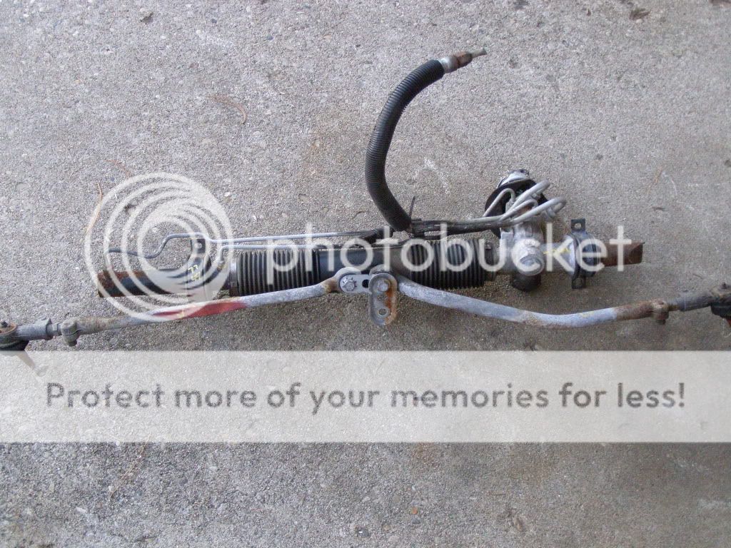

I bought a 98 Grand Am rack and pinion with both brackets and

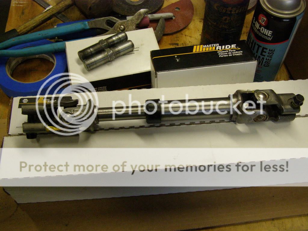

tie rods. and a 2004 Malibu steering shaft from the local junk yard.
I then bought new Inner and outer tie rods for a Grand Am, They work
out well.

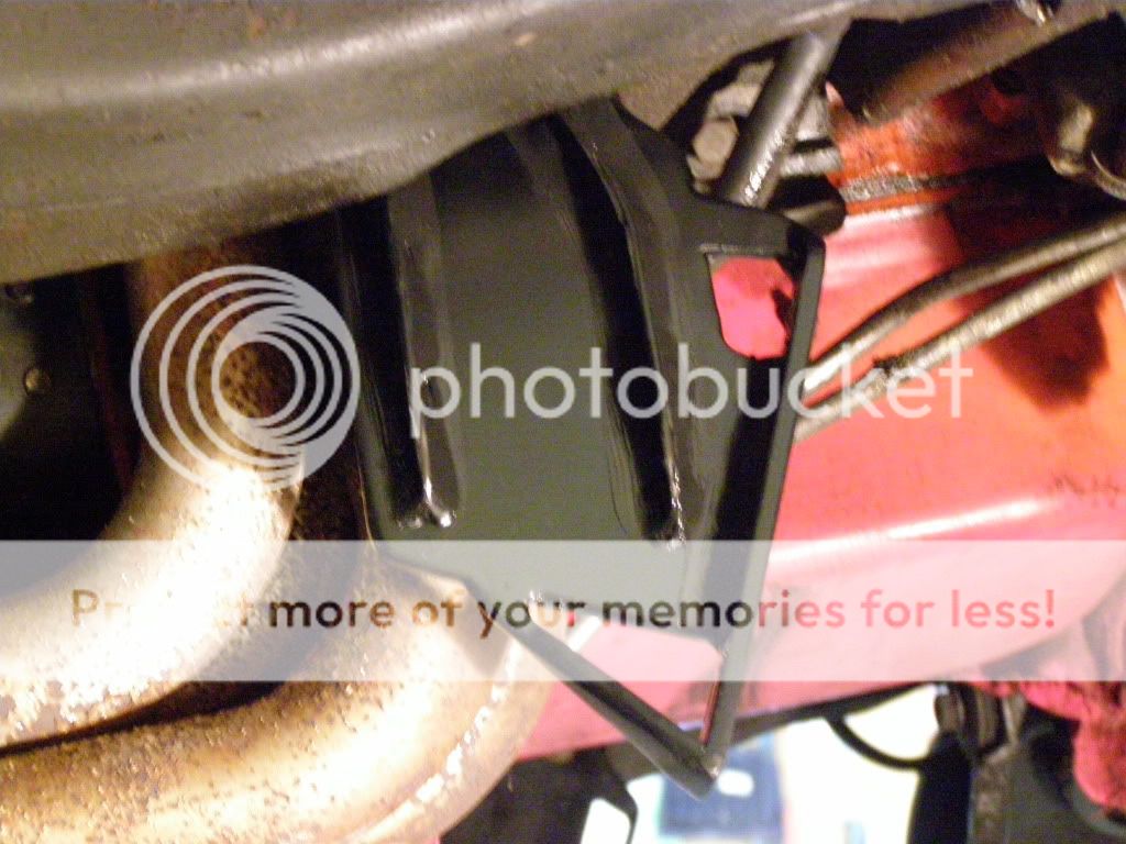

After tearing out the old system, I built the bracket to hold the
rack. I used the original hole in the frame to bolt in the new setup.
The material I used for the brackets is 3/16 flat steel.
I then took the steering column out of the car and altered the
end to except the Malibu steering stem.
Then reinstalled the column and the steering shaft into the car along with the rack.

Now I built a center bracket out of 3/16 flat steel cut two pieces
2'' wide by 5'' long welded it at a 75 to 80 degree angle, drilled
for the mounting and tie rod bolts, and installed it and the tie rods.
Every thing is in and looks like it will give me no problem. I am

I do have some templates that I started but did not make all templates
necessary to reproduce these. I fit the driver side vertical bracket on
then applied the horizontal bracket and gussets and welded it on the
car to get the fit right. I my be able to post the templates for the flat
main bracket, left and right side, but the rest would be up to you, if
I still have them.

I really like your driver and passenger side brackets- very clean.
I'd like to know how the grand am tie-rods work out for you, bump-steer wise
See? I told ya it wasnt too bad

Do they both bolt straight on without extra holes or just the driver's side? Are the shims under the rack mounts to get extra clearance around the pan?
lsejlowe is offline   Reply w/quote Quick reply to this message

The tie rod set as is should bring great results as far as minimal
bump steer. The tie rods run along the same angle as the lower control
arm, so I shouldn't see the toe change much, if at all with the
suspension travel.
Isejlowe,
Yes both support brackets are bolted through the original bolt locations,
I didn't want to weld any thing to the frame in case latter I go with
anther setup/system I can just on bolt everything and I wont have
to clean up any unwanted welding.
The shims are to lower and push it forward just a bit, When I built
the brackets I didn't get the rack location as close as I once thought
so the shims were the safest way to move it forward with out
having
to re-due the brackets.
