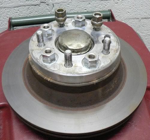

Here's a photo of the adapter bolted onto a hub assembly, the wheel then bolts onto that:
All factory C4 wheels have recesses in their mounting surface so the nuts that bolt the adapter to the hub are housed in the recess.
