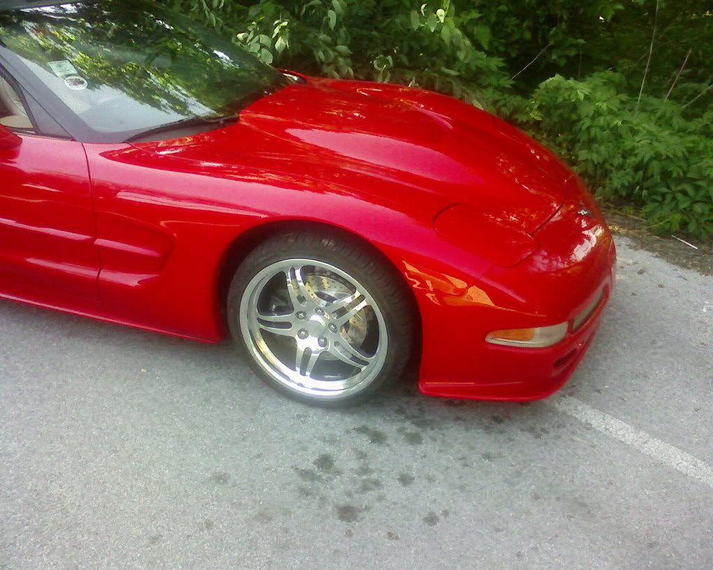

dont worry all you need is a spacer (and longer studs for mine) i have the 505a's but im sure yours are the same size here are some pics
and here is what the front looked like before
C6 Z51 rotors and brackets behind my SP500's.

CCW 505a an 06 Z06 big brakes
I have CCW 505 and z06 big brakes on a white 2003 vert. It looks awesome. Also run 19" wheels all around.

You really need to discuss with John or Chip at CCW. Putting in spacers and extended bolts is very tricky. The problem with real "big brakes" is you can't have a very deep lip due to the need for additional offset. They are familiar with all the "big brake kits" out there and can guide you on your pruchase. I have CCW 500A's with full Wilwood big brakes front and rear. It did reduce my lip width but you can't have both and still keep the tires within the fenders.
Thanks for all the replies guys, I have decided to go with the Baer Plus not the Plus +2 John at CCW said I would have to add a spacer in the rear with Plus +2's the Plus model is still a two piece brake and zinc washed so they will be lighter and not rust but OEM size.:cheers: :cheers:
