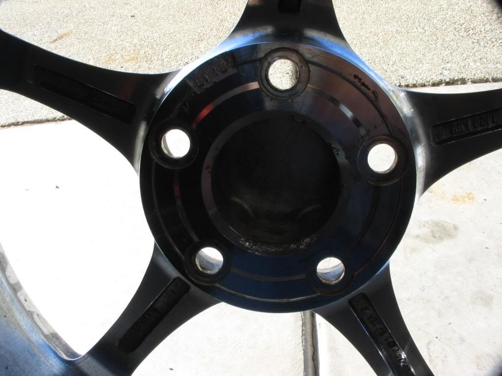

When I went to do this for my 1980 Corvette I recently purchased, I couldn’t find too much on how to install, or what to look for in a wheel spacer to use modern C5 wheels.
I saw that Bee Jay had some C5 Z06 wheels on his car and I PM’d him about the wheel spacer’s he had used to accomplish his look. He had used a 2” spacer, and then told me to use a 2.5” spacer for the Y2K C5 wheels I wanted to use.
Well, I picked up my C5 wheels off a friend of mine for $300 with tires. I just needed to acquire a set of 4 spacers. Fortunately, I did NOT need a “Wheel Adaptor”.
A wheel adaptor has 2 different bolt patterns. So that you may use a completely different rim. For example, you wanted to run BMW rims on your Corvette, you would need an “Adaptor” to change the lug pattern over to metric to accommodate the BMW wheels.
A Spacer just moves the same bolt pattern out from the hub of the wheel the desired length.

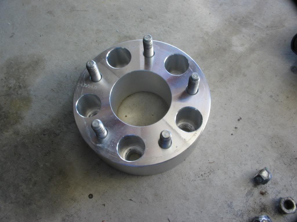

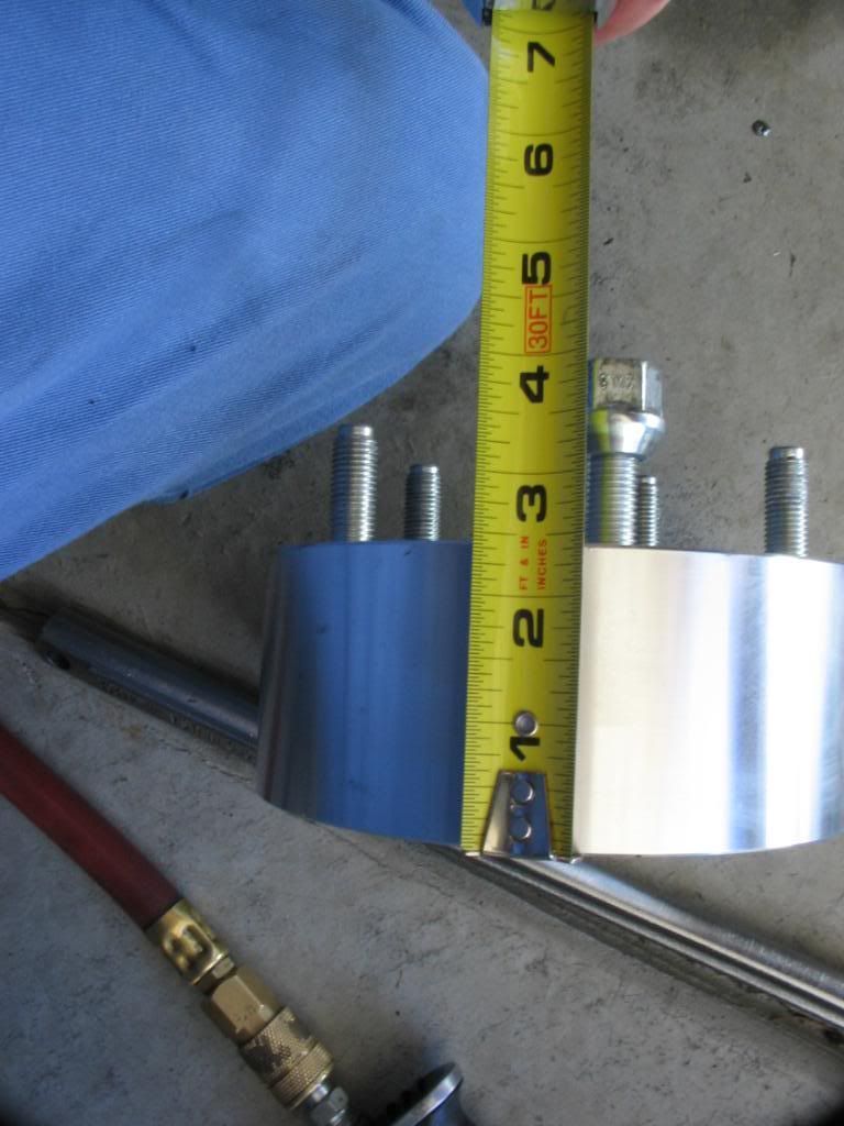

I was able to purchase a “Pair” of 2.5” Wheel Spacer with a 5x4.75 bolt patter for only $90 shipped!!!! To me, that was a bargain! AND, there hub centric…even better!!!!

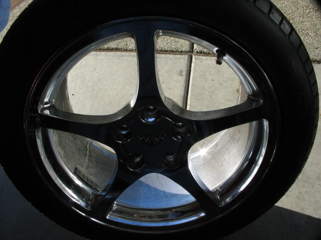

I bought a pair to try them out. Well, they worked out PERFECT. So, I bought another pair and now my car has the stance and the wheels I wanted for it.
Here are some pics to help out with anyone doing this mod;

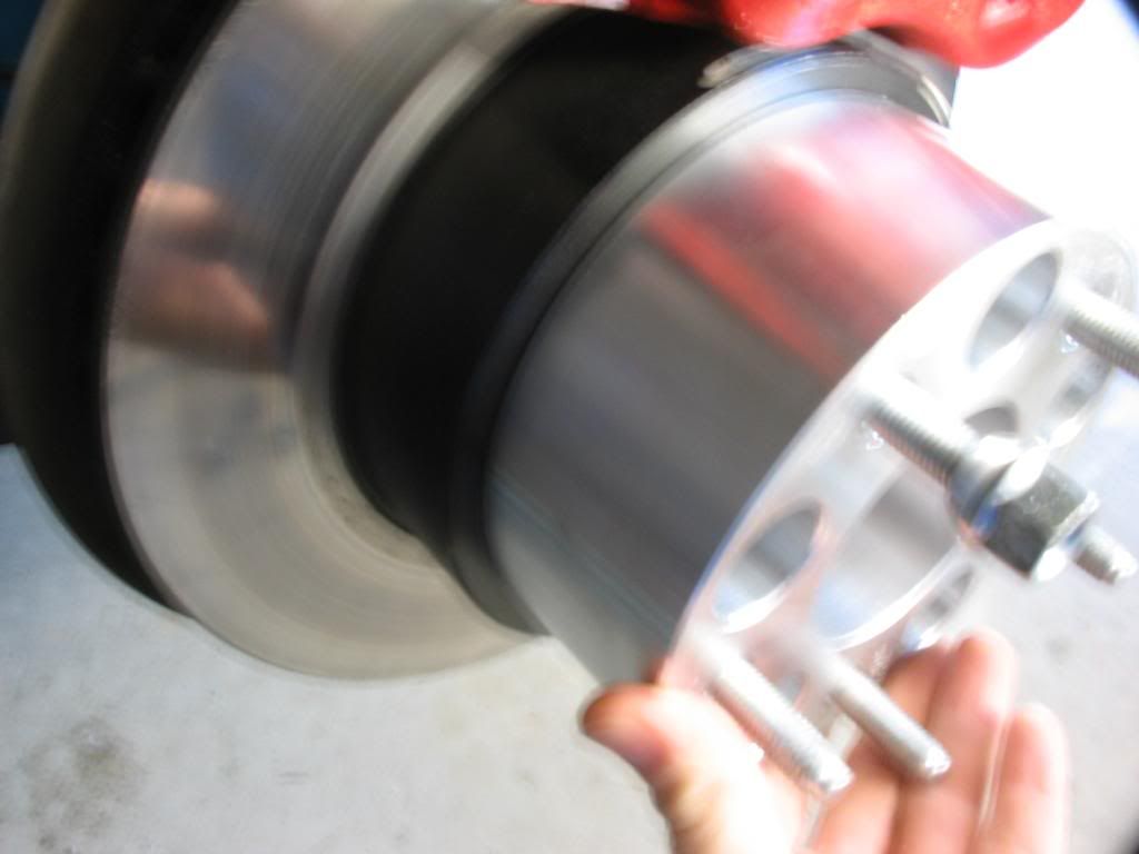

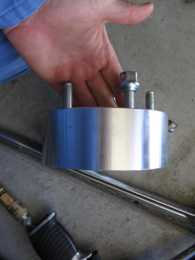

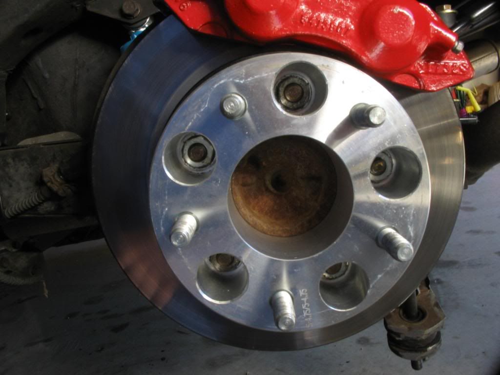

Here is what the Wheel Spacer looks like up against the rotor;
2.5” spacer!

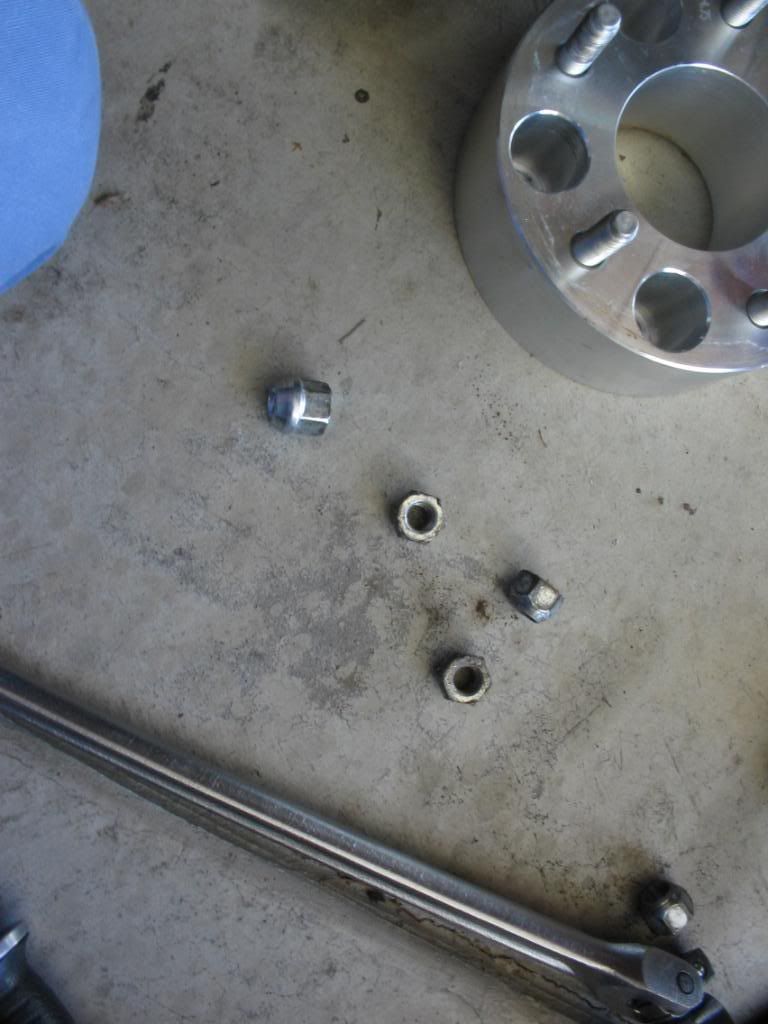

Mine came with some new Acorn nuts. Keep in mind; they are a DIFFERENT THREAD PATTERN then the stock 1980 wheel studs!!!!!!
A couple of different pics of the wheel spacer and the lug nuts.

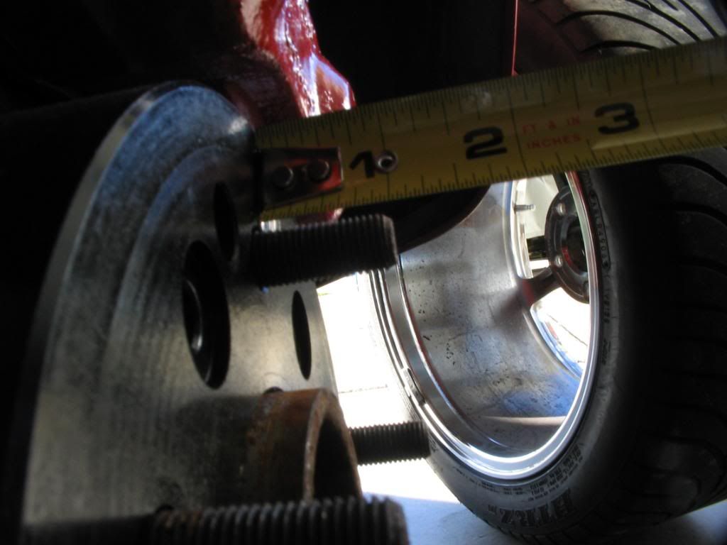

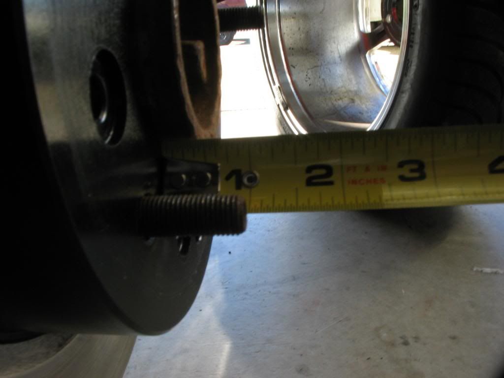

This is a picture of how far the stock wheel studs stick out from the rotor. That’s 1” to be exact.
I bought the rotors from Summit Racing. They come painted black like that. I just painted the caliper with some DuPont brush on caliper paint for about $17 at Napa or AutoZone.

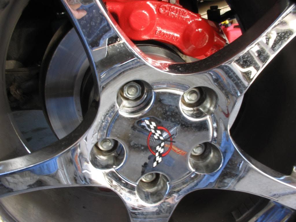

Remember to torque in a star pattern! The hubs came with a torque sheet saying to torque them to 95 ft-lb’s. Follow the instructions for whatever brand you buy!!!!!
Also, torque the wheels you have to the wheel manufacturer’s suggestion!!!!

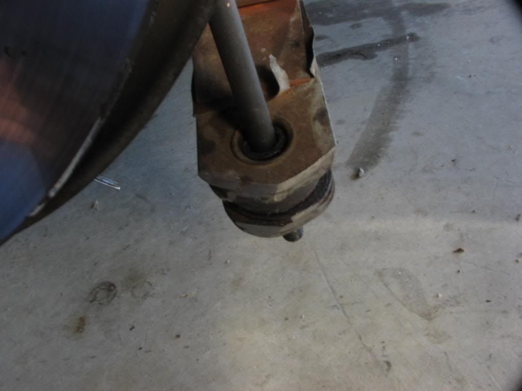

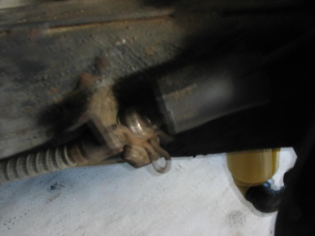

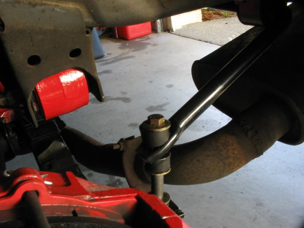

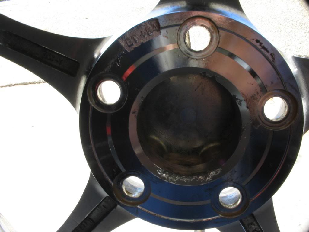

I had to grind the tab a bit for my rims to clear. Nothing major, about 2 seconds with the grinder took care of it and the stock steel leaf spring. I also run a VBP sway bar that I added. Plenty of clearance! And, I run the stock T/A.
There are no reliefs in my rim to run extended wheel studs. So take your measurements carefully before installing NON-stock wheel studs.
Would I recommend longer wheels studs? YES! The stock one’s are so short, there a PITA to get the acorn nuts started. You have 1.5” of wheel spacer before you ever hit the tip of the wheel stud, as you can see in the pictures below.
