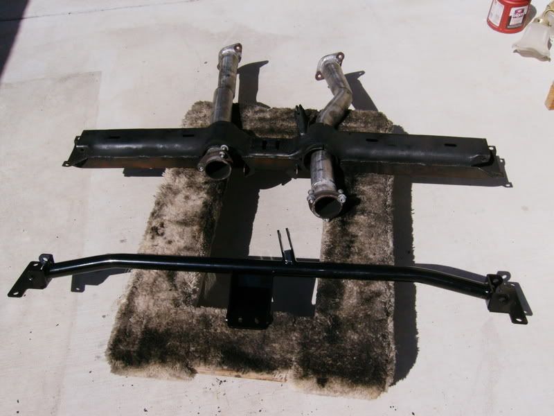

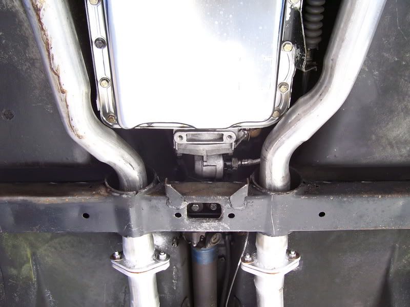

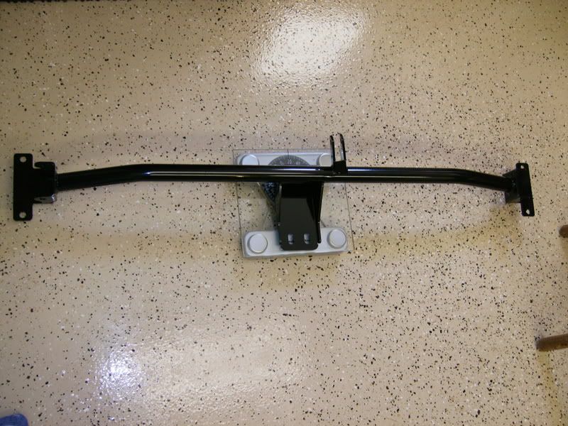

I got my Bowtie Overdrive Crossmember yesterday, and of course I went to intstall it immediately. First I weighed it. It's 18lbs, the stock crossmember is about 23lbs. Only a 5lb savings, but it looks much better. My early 700R4 has two trans mount positions. I had been using the rearmost with my stock crossmember. The Bowtie crossmember wants to use the front trans mount and there is major interference between the crossmember and the rear mount. What's up with that. Do later 700R4s not have the rear mount? What should I do. Find a later tailpiece. Order the 80 Crossmember? Help!

That's realy odd. Almost looks like it should be mounted backwards. Obviously the pully bracket wouldn't work, but it looks like the mount would be in the right place.
You do have an odd tail piece. Mine bolted to the two that you have unused in this picture forward from the cross member

That's what I thought. How hard is it to change tailpieces? Can I do it with the trans in the car? I wonder if Bowtie makes a crossmeber that uses the rear most mount.

I have another trans mount pad where the crossmember bar wants to be. Yours only has one mount pad. What year trans do you have?
3,100 Posts
I'd be a little concerned about mounting the trans that far back. The tail housing is pretty thin, and only held on with 4 bolts and a 3/16 flange. Not hard to change- pull the speedo adapter, remove the 4 bolts, and it'll come right off. Put some anti seize on the bolts when you go back- the steel bolts tend to corrode in the trans case. I've twisted a few off and had to drill and tap. Looks like your speedo adapter is leaking too. Get a new oring.
3,100 Posts
That pic gkull posted looks like most 700's. I wonder if there is a plate or something that's missing from the mount. Thinking about it, I don't recall seeing a mount that was exclusive to the tail housing. SOme of the later Vettes and F bodies had a torque arm that mounted to the side of the tail housing, but still had the rear mount ON the case. Even the 4x4's had the mount on the the case.

My old brain is starting to remember. I did this 700R4 conversion over 20 years ago. Yep, I was blazing trails. Did the conversion before it was cool. But I think I used my 350 Turbo tail piece so that I could keep my 79 Vette yoke and driveshaft. The '82 driveshaft that came with the tranny would not mount up to my rear end, so I had the stock driveshaft shortened. I guess I need to find a 700R4 tailshaft that will accept my 79 yoke.

use the mount on the case, take off the tailpiece and grind off the additional mount for clearance. Issue resolved. Finding a 700r4 tailpiece set up for a mech. speedo may not be very easy.

That's what I tried to do. But, after they shortened the output shaft to fit the tailpiece, there weren't enough length on the splines left. So, we went to 700R tailpiece, and shortened the driveshaft 3".
