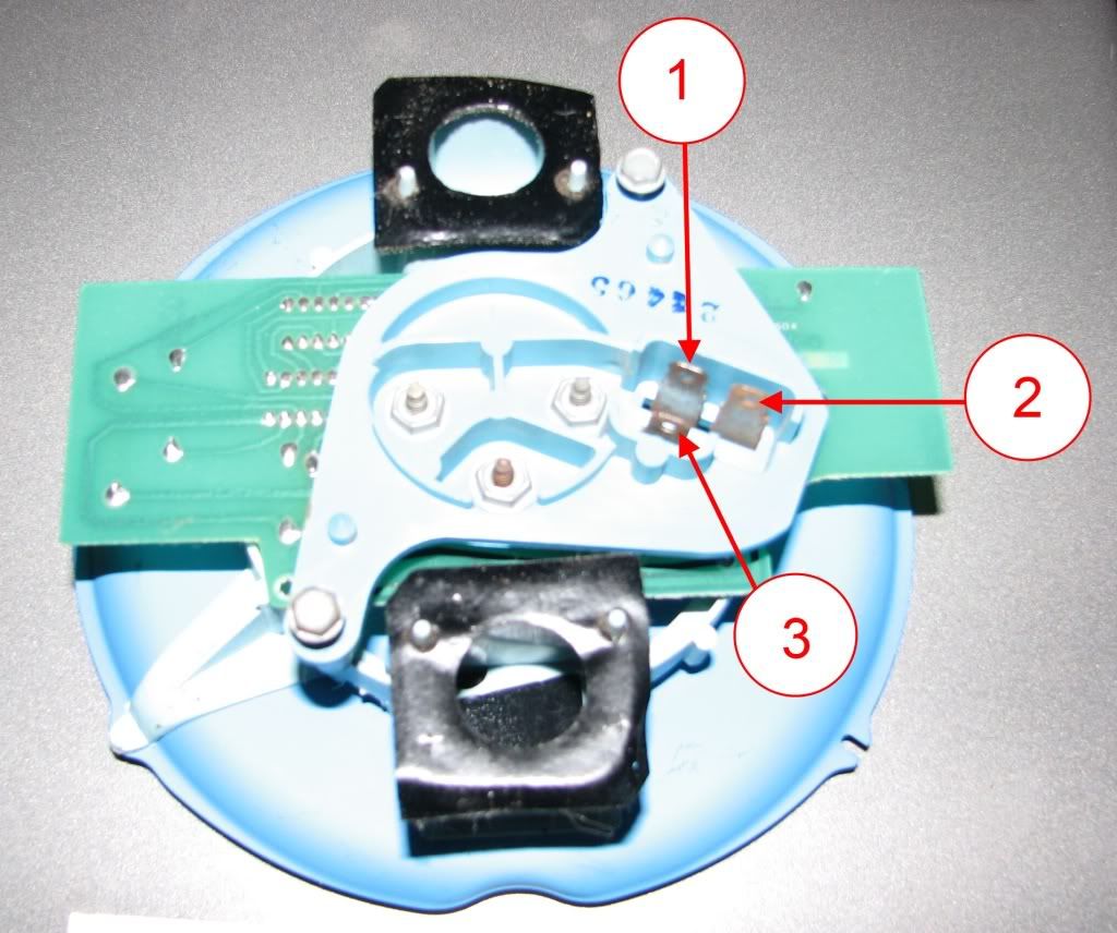

I've acquired a 75-77 tach for a future conversion over to electrical instead of mechanicl. However I'm not sure of the input designations for +12 power, ground, and tach signal.
#1 = ?
#2 = ?
#3 = ?
Thanks,
Jeff
676 Posts
Discussion Starter · #2 ·
By using a 9v battery, the only way I could get the needle to move was #1 = +9v, and #2 = ground.
So that would leave this:
#1 = +12v
#2 = ground
#3 = tach signal
