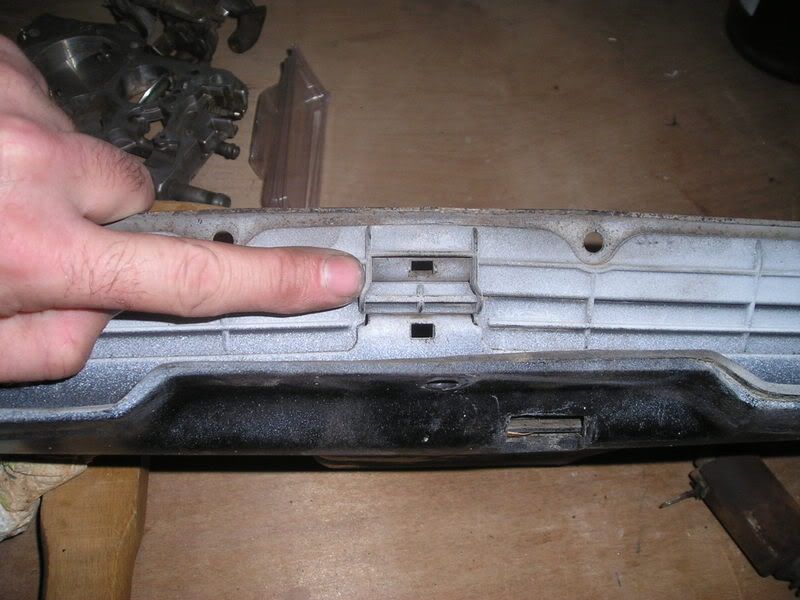

Anyone know where I can get the small plastic retainers that secure the hood induction flap in place. It should have 3 but mine only has the 2 outer ones and is missing the one in the middle of the flap. This is causing it to jam and not open fully.
TIA.

well after being told by an 'expert' at Ecklers that no cold air induction system was ever fitted as standard to any corvette, I decided to make myself a clip.
Now have the flap operating correctly. Opens almost 90 deg!
Still looking for an original clip though....:thumbsup:

I have an old 73 hood out back and I'll look and see if it has on eon it.If it doesnt I'll see if I can find the original GM# if that will make the hunt any easier.

Jotto-My old busted up hood didnt have any left on it.I have a nice used 73 hood but I wont break it up.I got a better look at it and see those 3 clips are plastic.Doubt if they could be removed without breaking them.I cant see why you couldnt put a plastic zip tie around it adjusted just right and do the job-since you cant really see it.
I'll bet if you go to a swap meet someone will have a whole box of them and not know what they are..They are called a "Retainer"
Group# 3.415
Part# 3955227
List $.79

Retainer as per my first post....the part # is that GM? at $0.79 sounds like a steal! Went to GM parts direct for a look...is that the same place you guys use?

I didnt mean you didnt know what it was.I was just giving you exactly what it said in the GM Parts and Illustration Catalog from Dec.1983.Sometimes GM calls things odd names like the door (or the flap as you called it) they refer to as "valve".I just thought if you were going on a hunt it might help to have the "GM termonoligy" just in case you stumble onto something.Good Luck
