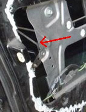

Hello...I replaced my drivers side window regulator this weekend.....and I am having an issue reconnecting my door lock mechinism.....does someone have un upclose picture of this area?....where the rod slides thru the pivoting assembly....for some reason mine is giving me trouble...and I don't want to start bending parts......thank you!!!
Please note the picture below is not mine....

The end of the rod has a curve in it to prevent it from pulling out so you will either need to remove that plate again or the lock set up to get it to go into the hole like it should.
