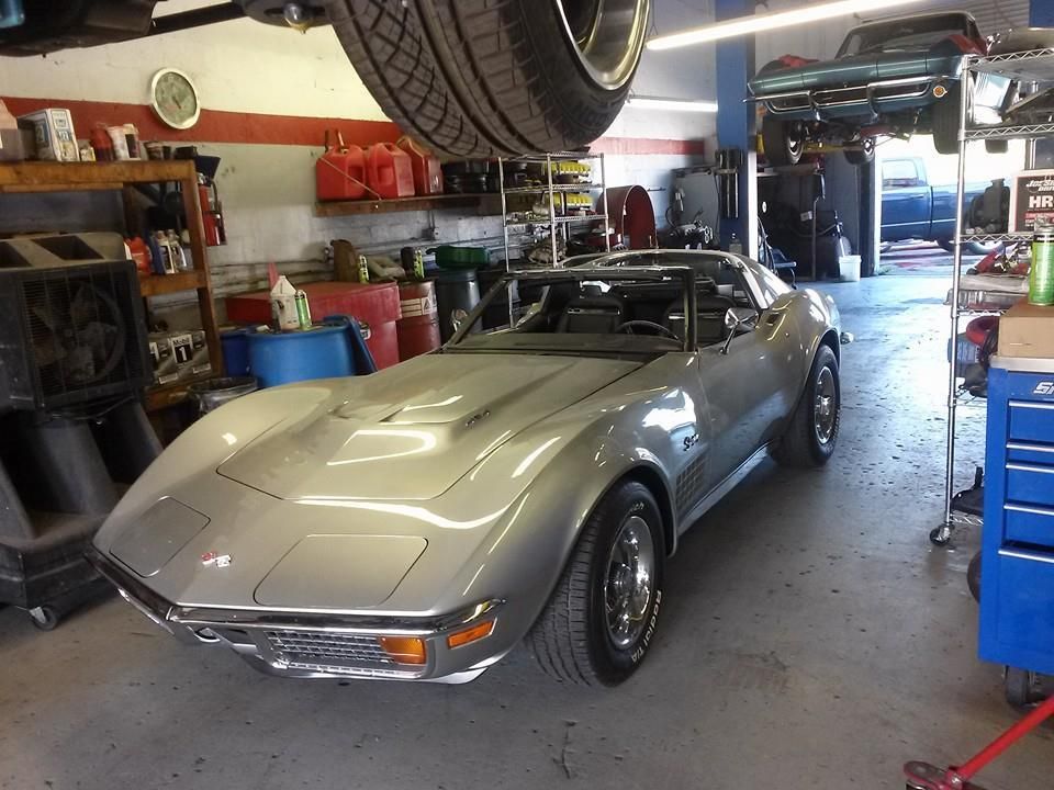

Here is another project we are elbow deep in. this is a beautiful 71 to start out with. we are tasked with an efi conversion, brake upgrades, offset trailing arms to accommodate the rims we are installing, it already has a tremec 5 speed trans but we are gonna convert clutch control to hydraulic. n get rid of all that z-bar and anti rattle spring and ball stud and shift fork stuff. also we are changing the gas tank, changing gears in the diff and theres probably more in the list i am not remembering. i will post pics of the progress and build as it unfolds.

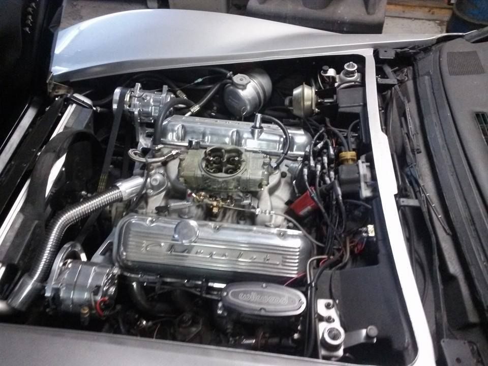

Nice- but I'm partial to Silver AND 71s!!!
Looks pretty clean- but it kills me -all that work and looks like they slapped the power wire for the fuel pump in there!!!
PS- What's a "Hellcat?" Is that a nickname for Hillary? That scares me!!!

Fear Not. and remember these pics. much of the wiring under the hood bugs the hell out of me, too. good thing i am installing fast easy efi on this beast. i will get to clean all that up. had a very hard time getting the transmission and bellhousing out of the car. so much so that i think tomorrow i am gonna pull the engine and install the engine and transmission together. i am not sure about that yet, but whatever i do, i will take pics.
