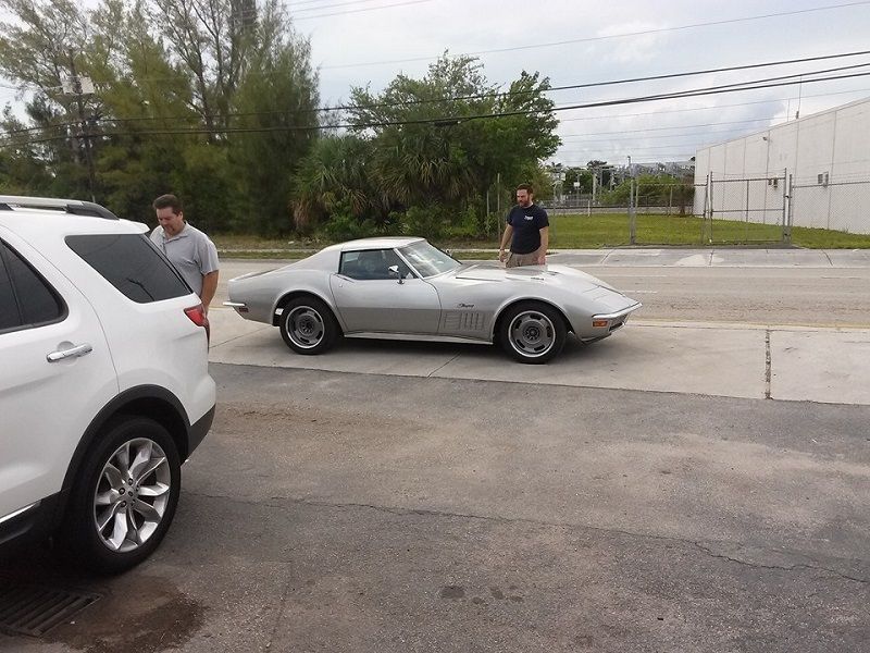

ok so great news. i have finished the 1971 big block car. and i would like to say it is a beast. but you don't have to taqke my word for it. tomorrow i gotta strap it down to the dyno and see what this thing can do. below is the man that makes all of this possible. the Real vetteXpert, Tony Gounis.
the car now sits a little lower and the center caps are installed. i will get pics tomorrow while it is on the dyno.
