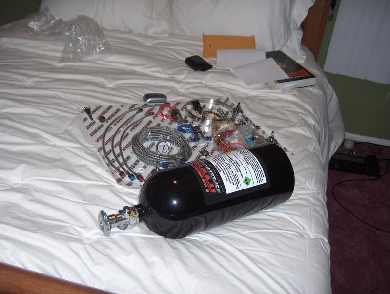

Hey you guys as you guys know i am in the process of painting my car, which i will prabaly post pics tomorrow since everything is done i just need to put everything back. Well my car is going to look fast with the gs stripe but i also wanted to be fast so i got the bottle. Well here are some pics.

Cool....ya can't go wrong with the Harris Speedworks Nitrous stuff.........Just make sure to run all the failsafes (FPSS, Pull Timing, Colder Plugs, Ect) and it should be trouble free for a LONG LONG time.......good luck with it....Joe:thumbsup:

What shot spray do you have?

Yeah ill make sure i buy the extras, after you told me the kit is good quality i went ahead and ordered it. Thanks for the input guys:thumbsup:
