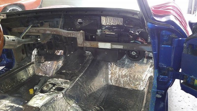

The floors felt a little thin to us So we decided to build them up. I am not a fan of working with fiberglass but what has to happen has to happen. So we sand the floors lightly, cut up some mats and mix up some resin. Here are the floors drying..
The red spot is from a previous repair. I sanded it down to the shape the floor should be in and though this picture doesn't show it too well there is fiberglass mat covering it. It is just clear under the resin. Once everything is dry, We try to reshape the floor with a durablock and some 36grit paper. At least make things flat again..
And we can start laying in the hush mat. Because of the frame and c7 suspension and huge diff and such wide tires major changes had to be made to the floor in the rear of this car..
And the floors are complete..

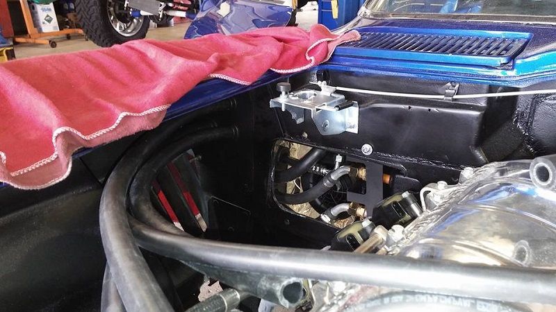

Spun my wheels in a couple different directions, today. Got the vintage air a/c box mounted to the firewall..
But fell short of mounting the blockoff plate to the firewall. I am undecided where to mount the ecu and if I decide to go inside the car, I will cut a hole in that plate. So for now it gets left like this..

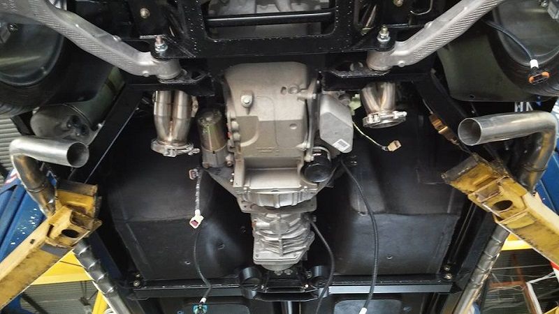

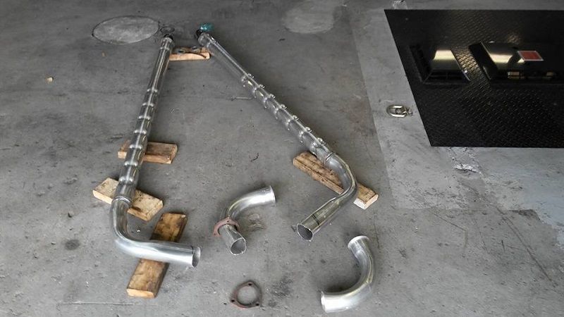

And I got started on the exhaust. The idea is to use stock big block sidepipes and covers. So we chop up the new sidepipes..
And have a clearance problem with the dry sump tank that we need to resolve..

So we need to get the exhaust around the dry sump tank. First we need to remove all the pipe from the sidepipes..
Here is a rare shot inside a factory sidepipe. Just like a glass pack or resonator albeit a bit longer..
With just a few elbows I made the exhaust gets around the dry sump tank just fine..
And here is the complete exhaust for this wild build O2 sensors mounted and all..
