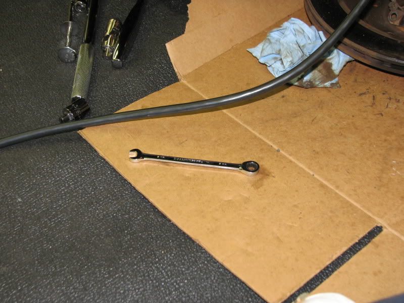

NOT NEEDED: 8 mm Gearwrench wrench (ask me how I know ...)

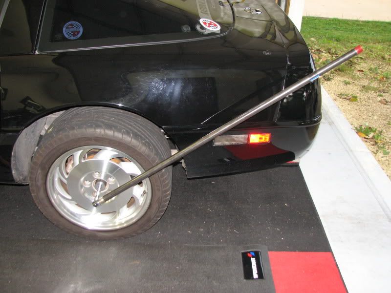

I removed the wheel, popped out the cover, and reinstalled the wheel, so that I could remove the nut with the full weight of the car helping me. This is where you'll need your 36 mm socket.
I initially tried to looen the nut with just my breaker bar, but I couldn't budge it, so out came the persuader.
I used a four foot persuader, and it worked just fine.

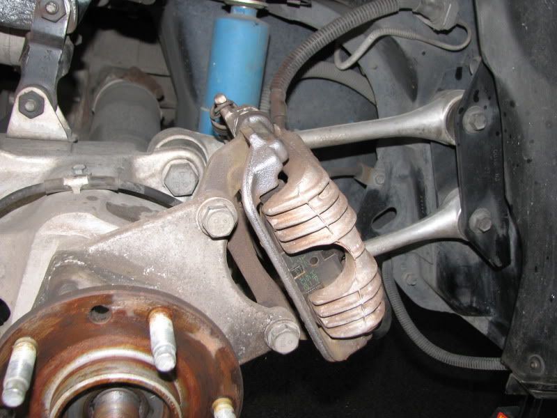

I removed the caliper bracket by loosening two 18 mm bolts located on the backside of the caliper. Once the caliper is removed, you can set it to the side. Make sure that the caliper is properly supported - don't let it hang down by the rubber hose, as you'll damage the line.
Once I disconnected the calipers, I thought that the rotor would be easy to remove. Wrong! The rotors have been on that car for nearly 15 years, and the rotors and hubs were quite attached to each other. I treated the rotors with AeroKroil, waited overnight, and then popped them off with a block of wood and a hammer.
Rotor Out of the Way ... Ready for the Next Step
I wasn't realy thrilled with the way the caliper/bracket fit on the suspension - so I thought of using the mounting bracket as a temporary mount - like so ...

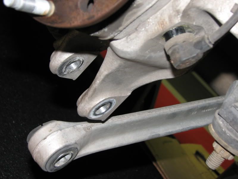

3 - Detaching Suspension Stuff
The next step involves detaching enough suspension components to allow removing the halfshafts. Once those are out of the way, then the hub can be removed. The Factory Service Manual doesn't require half shaft removal, but I think the job would be much harder that way. Since I couldn't accurately judge the condition of the half shaft u-joints, I elected to remove and replace them.
To accomplish this, the lower camber strut rod, tie rod end, and spring all need to be detached.

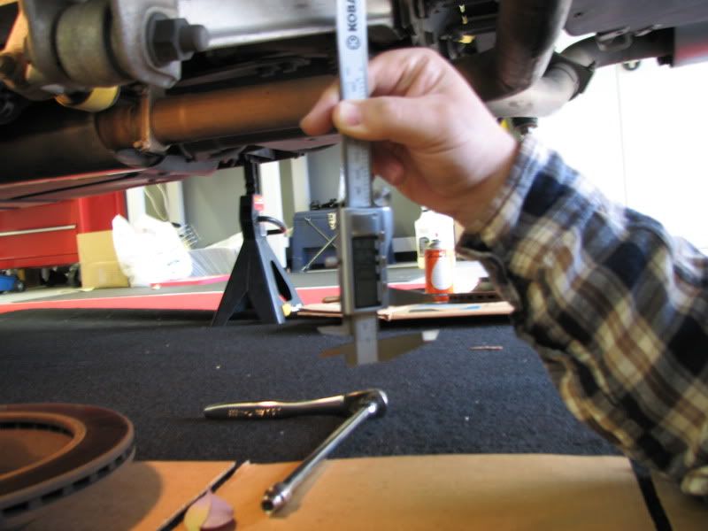

In order to get the ride height back to the original point, I considered counting threads from the bottom of the spring bolt. But then I got out my digital caliper and measured the distance from the bottom of the spring bolt to the nut.

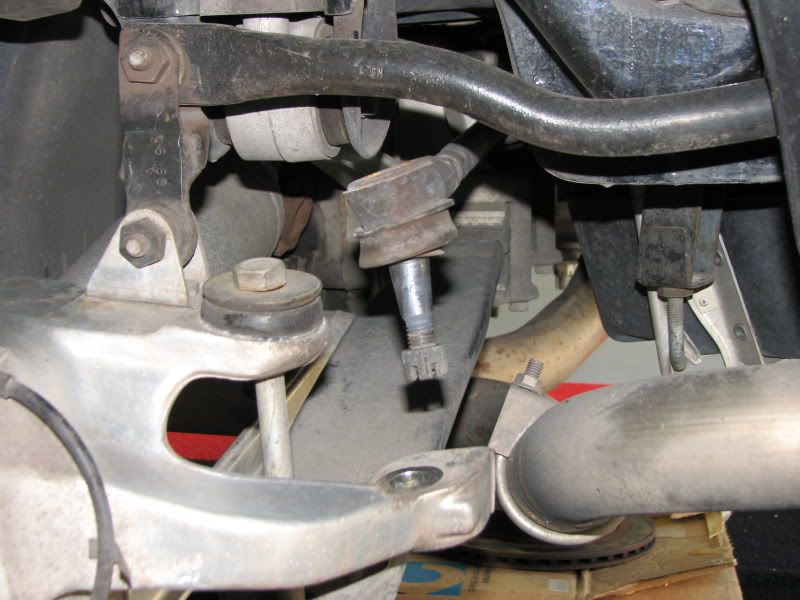

That done, I then removed the tie rod end.

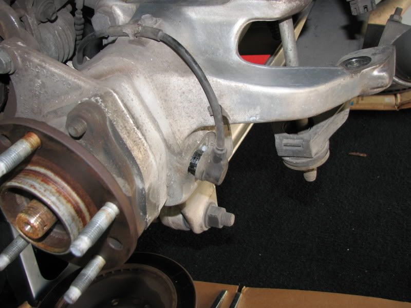

I wanted to make sure that the wheel speed sensor wasn't damaged during the process, so I loosened the mounting nut (10 mm), and slid the sensor part way out. I only wanted to get it away from the axle gear, so I left it in.

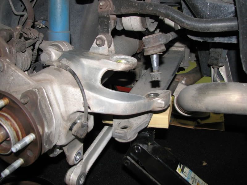

I then removed the camber strut rod. Some places I researched recommended disconnecting the strut from the camber adjustment point. Of course, that requires that you also carefully mark the position of the camber adjustment. I thought it would be a lot easier to simply remove it from the other end. These are 24 mm diameter.
It didn't take much convincing to remove this - I used a short block of wood and my hammer to drive it out.
Side Note: Now I'm really considering a project to replace those original bushings with polyurethane units. It looks like it would be a fun project!

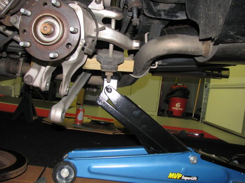

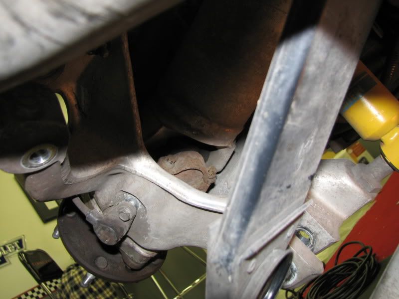

OK - now to disconnect the spring. The basic concept is to use a jack to take the tension off the spring, thus allowing you to remove the spring retainer bolt.

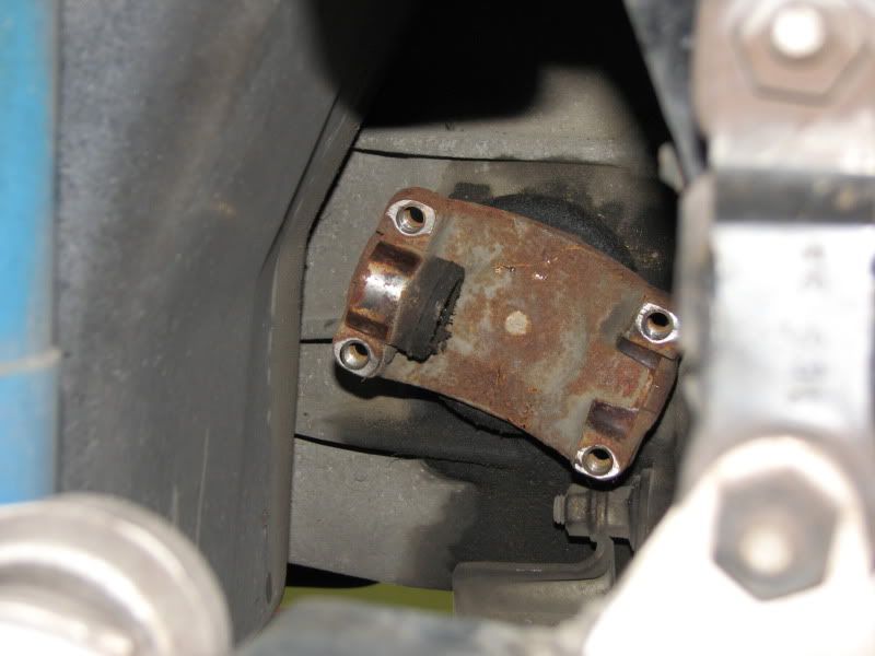

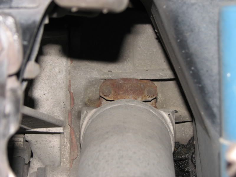

The first step was to loosen the 8 mm bolts hoding the u-joint straps in place. I loosened the inner strap bolts first. My approach was to line them up like this ...
Then, with the car in gear (actually, the first time it was with my son holding on to the pasenger side hub), I took my 3/8" drive ratchet and long extensions to reach in and loosen things up.
Once I broke the inner straps loose, I got under the car and loosened up the straps on the outer joints. Those were harder to get to.
I wasn't sure what was going to happen after I removed the straps from the u-joints, but I didn't really expect the u-joints to be frozen to both the axle and the differential! As a 'just in case' measure, I put the 36 mm axle retaining nut back on the end of the axle, and used a pry bar to break the inner joint away from the differential. Once it let go, I removed the nut from the axle, and not seeing any easy way to break the u-joint free of the axle, I just pulled the entire assembly out.
Side Note: About that 8 mm Gearwrench ... While I was under the car loosening the outer strap, I looked up and there was the slightly loosened strap from the inner side. I had a quick vision of removing those bolts and straps while I could easily see them, so put my trusty Gearwrench on the bolt, and made two swings ... then it occurred to me that the BOLT and the WRENCH were heading straight for the SHAFT, and I was going to get SHAFTED if I didn't get that wrench OFF the BOLT before it moved too far ... since my Gearwrench isn't one of the nifty reversible kinds! It was very nearly stuck in place, and I had to do some major grunting and groaning to get the stupid wrench off the bolt head! DON'T DO THIS ...

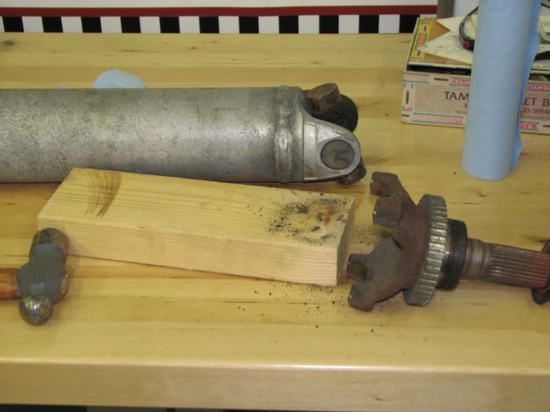

I took the shaft/axle assembly to the workbench and a couple of quick hammer blows on the old u-joint cap separated the axle from the shaft.
A quick inspection of the caps, needle bearings, and u-joints revealed a good amount of wear, so replacing the u-joints was a worthy investment. In the interests of time, I took the half shaft to a friend of mine to replace the u-joints while I went back under the car.

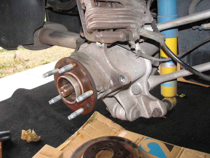

6 - Remove Hub
You need a T55 Torx bit to remove the hub bolts. They are located inside the suspension member, and can be very, very stubborn.
I had my Torx bit attached to a long extension and my 24" breaker bar. I was really wishing that I'd jacked the car up another two inches, as getting to the lower Torx bolt was a bit tighter than I wanted.
Remember that nifty idea I had to put the calipers back on the mounting bracket? What I didn't realize was that the caliper mounting bracket isn't part of the suspension member - it's held in place by the Torx bolts that secure the hubs. So when I got the three hub bolts loose, I couldn't figure out why the bolts were so reluctant to come out (I was still under the car). After I got the first bolt loose, I was working on the second one when I noticed something moving. So I crawled out from underneath the car and saw the problem. I then removed the caliper from the mounting bracket, and zip tied it.
This picture shows the hub and mounting bracket removed, with the caliper assembly zip tied.
This picture shows the mounting bracket installed, with the Torx bolts ready to accept the new hub. I liberally applied anti-sieze to the Torx bolts along the shaft and on the threads.

Then it was time to raise the spring and put the spring bolt back in.
I set the distance between the end of the bolt and the nut as previously measured with my digital caliper, and installed a new cotter pin on that one too.
