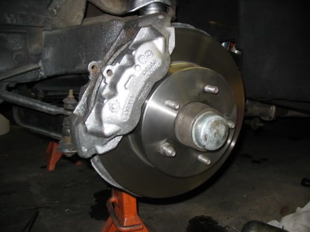

Getting ready to paint my calipers again. Right now they are silver, should I leave them that way or paint them the color of the car. Also, what kind of paint is everyone using, epoxy, engine paint??? Hows it holding up??? Thanks in advance for any info.;)

Any high-temp paint will do it. For best adhesion, you are going to want to clean the hell out of those calipers and get all the brake-dust off of them. Brake cleaner works well for this.
And, I would mask off the caliper and spray-paint them using light coats. I would not brush it on.:thumbsup:
A high temp epoxy would be good.
After the wipe with brake cleaner and masking, follow up with a light wipe with laquer thinner.

I used red high temp 1200 engine paint, till I get them powdercoated or go to C5 brakes
I used High Heat aluminum on mine 2 years ago. Still look like I just painted them. I did the rotor hubs too.
Used the $39 kit from MAD and probably wouldn't recommend it.
Colors are kinda washed...you brush it on...absolutely need multiple coats just so it will look good.
I used the red kit that is too orange for my taste.
Spray sounds like it would have been a better option...or take them off and powder coat them!

Man, I got a brush on caliper paint kit I think it was Duplicolor from my local auto parts store,which came with the brush ,paint and caliper cleaner . I did 2 coats of red and they still look great. I recommend the brush on type because there is very little masking to do. With spray paint you need to mask off the entire wheel well and you will still get overspray on some parts. I'm not saying it can't be done it's just a lot more work then the brush.If you use the brush on kit one tip, don't worry about getting a little paint on the corvette logo,after everything is dry just take a small pc of wet/dry sand paper and sand the letters back to a like new shine.
