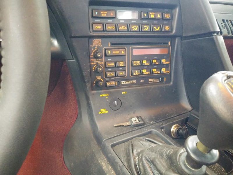

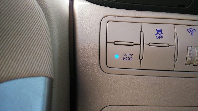

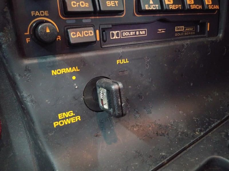

Oh how we have gone down the drain over the years. There can be no arguing. Recently I had a rental car, and I am proud to say it was a rental and not on something I owned or paid my hard earned money for. But I rented a sleek sexy import with this..

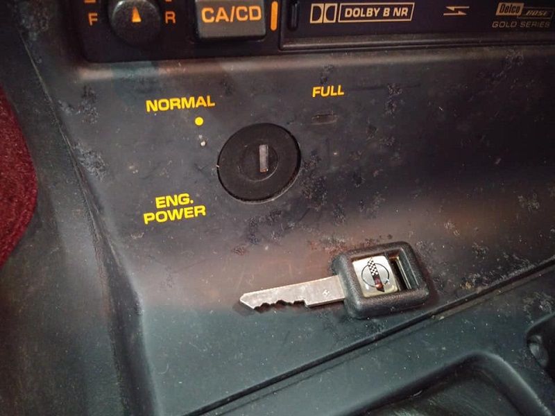

Such a long way have we come over the decades. LOL. Corvette ZR-1 back in 1993 had a switch to control the engines output. But it read a little differently..

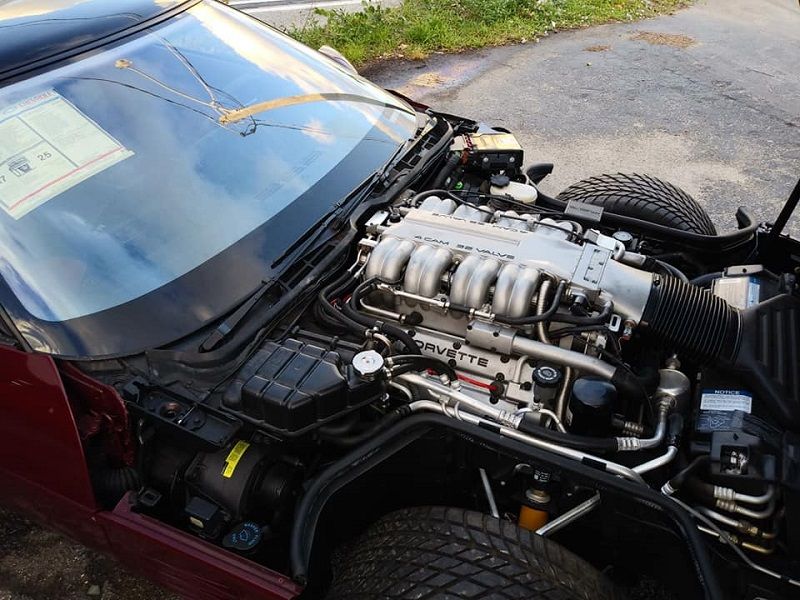

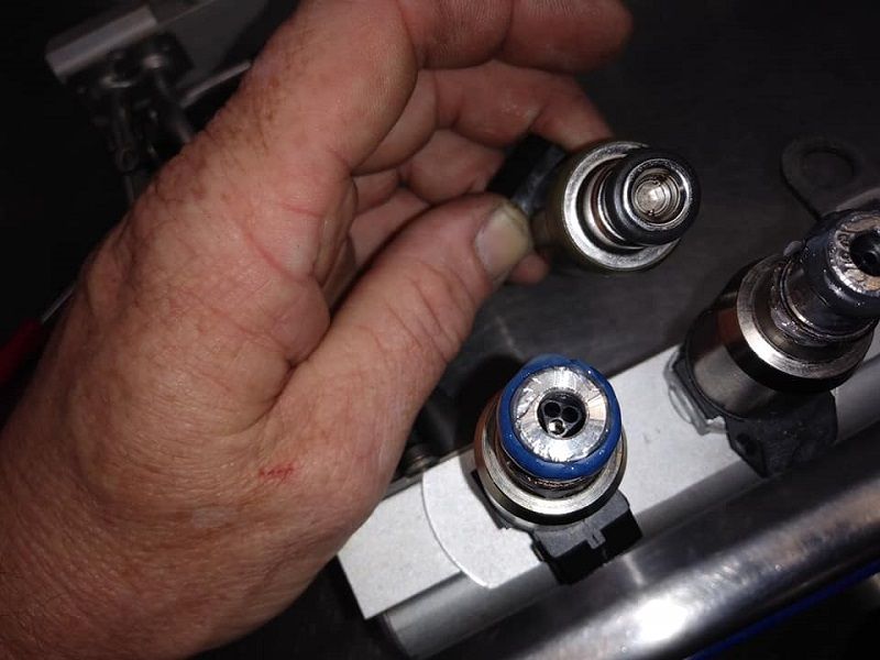

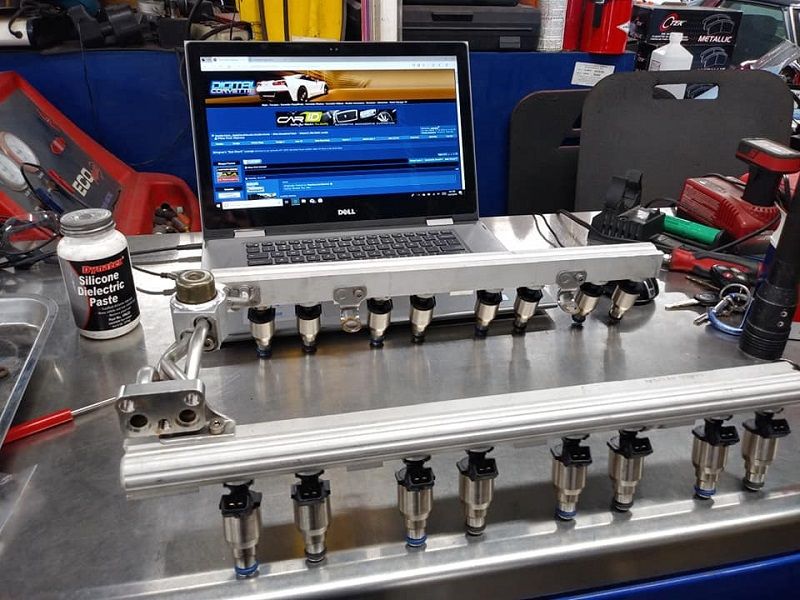

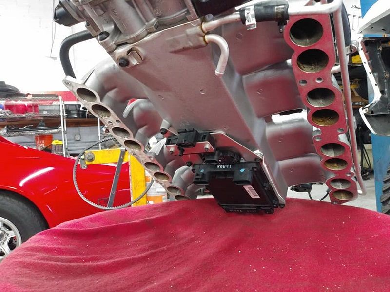

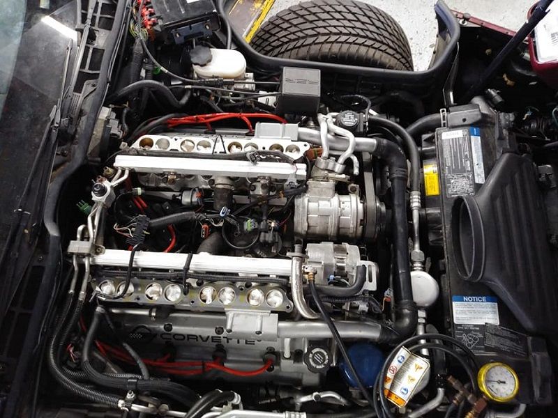

So this car is in for a no start condition. The window sticker still being in the windshield really tells a tale of no miles and extremely long times spent sitting. The fuel tank was serviced and the fuel pump changed before the car came to us. My diagnostic process has led me to bad fuel injectors. We have good fuel pressure at the rail. And we have injector pulse at the injector pigtails, but when I charge the fuel rail and energize an injector I don't see any pressure change at the rail indicating the injectors are unresponsive. So the plenum needs to come up..

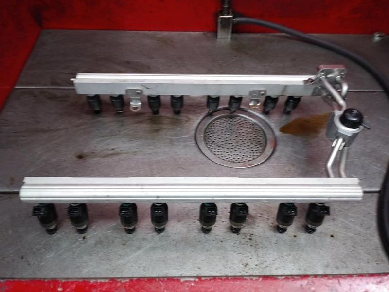

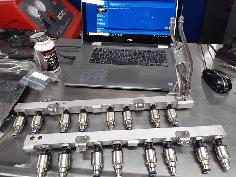

And we can access the fuel rail and injectors. Here are those parts removed and ready to be stripped down..

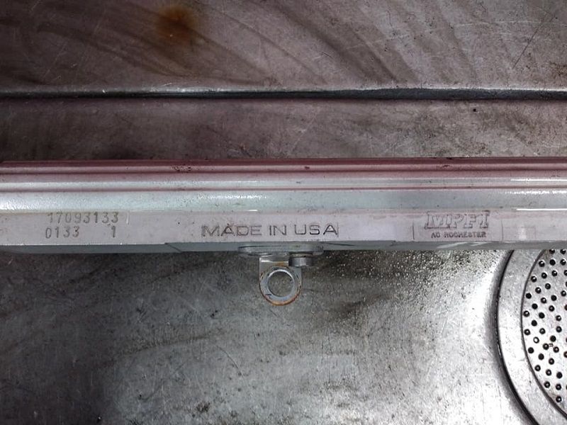

This right here is the reason that all Corvettes are so awesome..

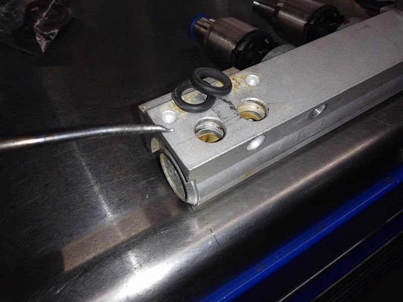

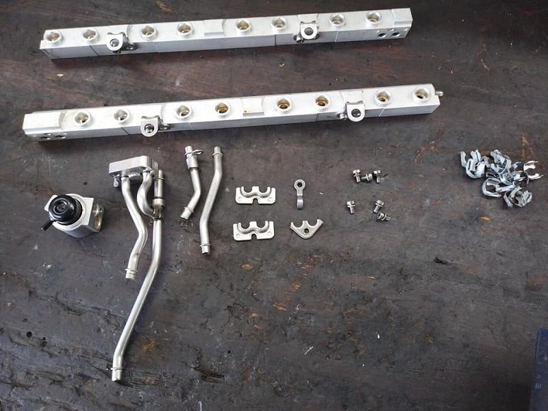

And here is that fuel rail all broken down and ready for rebuilding..

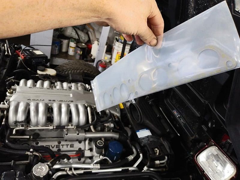

Woa. Look at this. Specific plenum gaskets for an old LT5..
I remember making a set of those before. but we found an injector supplier that offered these gaskets. So that is who we went with. The new injectors have a new design nozzle and spray pattern..
All O-rings need to be changed in this assembly..
Going back together we can see that this whole ZR1 fuel rail rebuild went down live on DC..
