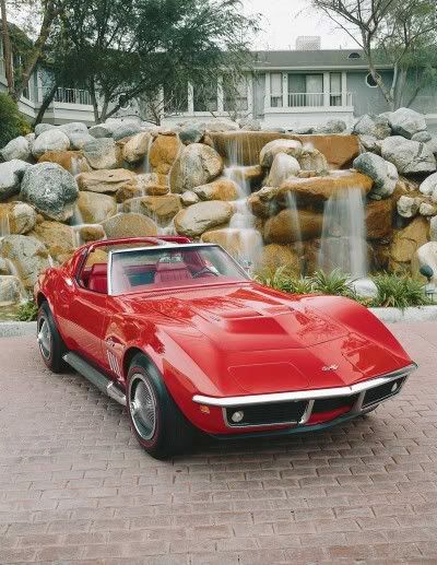

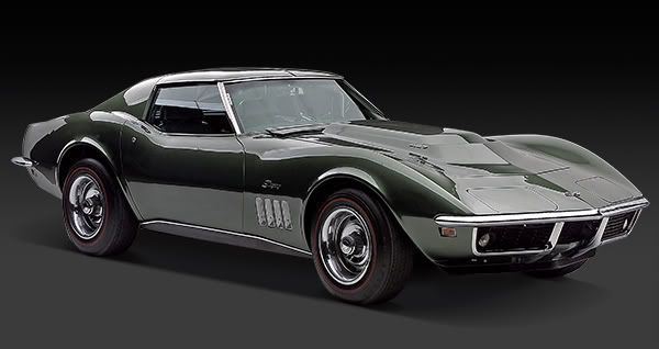

So it's between the L88 long style big block hood or the regular Big Block hood.
Any thoughts on which way to go? I'm kind of on the fence, Is there a benefit to one over the other? I know the L88 long hood eliminates the wiper door, good thing perhaps?:huh:
L88 Hood
Big Block hood

L88 hood, no question. Find a car with one and look at it from 100 ft away.
Plus, the BB hood has minimal clearance for an aftermarket intake.

I personally like wiper door as it adds character to the earlier C3's (and I've never had an issue with mine opening or closing, knock on wood :laughing:). That said, I think it looks goofy as hell with the L88 hood as shown in the first pic...
Yes :agree: I guess that's the L88 short hood...I noticed that too.
