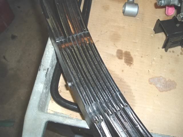

I'll just add this, it's for a multi leaf but should give an idea based on what variables are in there
multi leaf spring rate (roughly) = (((leaf width * # of leaves)/12) * (((1000 * thickness) / length longest leaf eye to eye)^3))
Well, the fiberglass one isn't a multileaf, msot have a variable thickness and width...but the length.... :)
Those dual mount leaf springs do exacty what Jim says, but the other way aroudn. They move the 2 mounts in and outboard to change the free length sticking out on the sides, this does change the spring rate.
