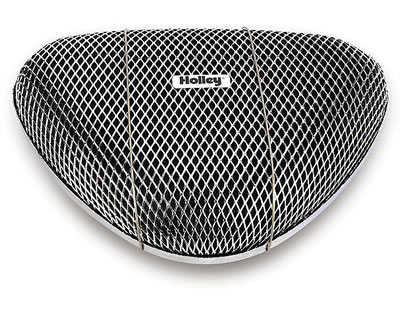

My question is "How on earth do you attach it to the carb" I have a Holley 670 Street Avenger, so it should be easy to attach. I've looked at it from every angle but still don't get it. I see the bracket, but when I tighten it down, it still turns on the carb.

Nope, hood clearance is not the issue. How does it attach to the carb? It doesn't have any instructions that came with it.

Unsnap the two wires that hold the grill to the top of the base, remove the grill and the foam filter. The attachment nut for the bolt coming out of the carb's airhorn is under this. Be sure and safety wire the nut, or use locktite. Fibration can loosen the bolt and it can be injested into the engine. Be sure to use the rubber gasket. This should prevent the filter from turning on the carb after it is snugged down.
This "filter" will only prevent sticks, stones, and small children from being injested into the engine. I'd never consider it for a daily driver.

When you say it turns on the carb, do you mean after a few miles it goes crooked by 5 degrees? They do that. Plan to straighten it out when you arrive at cruise night, and pray that constant moving doesn't cause the hidden hold down nut to loosen & drop into the carb throat.
