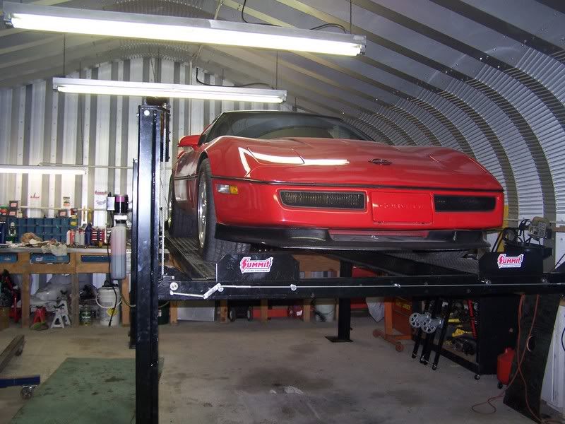

First get the car in the air. I had the use of a lift but this can be done just as easy on jack stands. Even with the lift you need to put the car on stands so that the rear tires are about 1" in the air.

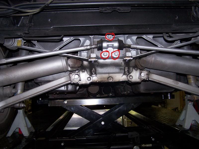

Remove your rear leaf spring. Do this by removing the side bolts first support the end of the spring with a jack and remove the nut and bushing. The bolt is 13/16 and the nut is 22mm Take note of how many threads are showing as this is your ride height. After that remove the 4 bolts in the middle. These are 15 mm Be sure to take note of the spacers and shims on this part. The bolts are circled in red.

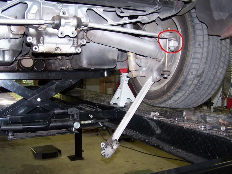

Now that the spring is out of the way remove the end links that attach to the center of the housing. I had to remove one end to remove the half shafts (that comes later) so I used a pickle fork and swung it out of the way.

Next you are going to remove the lower arms. Just remove them from the housing and swing them down.The nuts are 13mm and the bolts are 15mm.

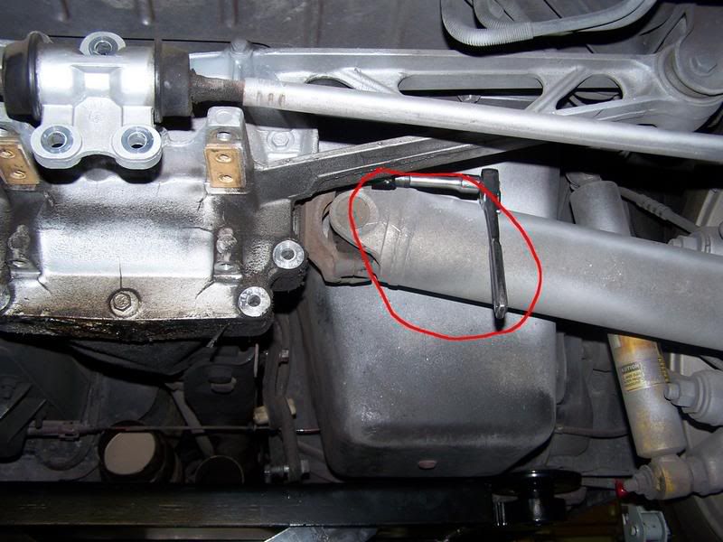

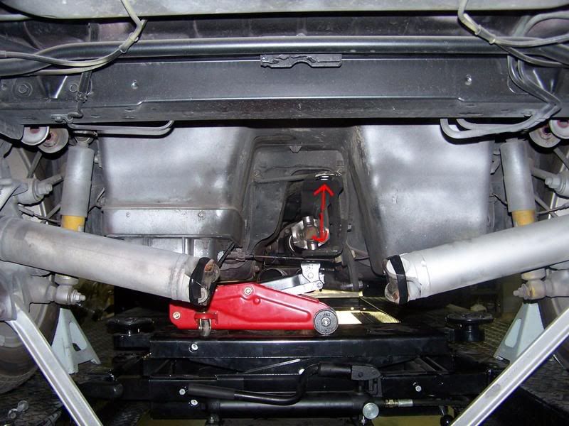

Now your onto the halfshafts and driveshaft. All of the bolts here are 8mm. Shocking isn't it? There is no easy way to do this I found that with the shafts in the position in the pic below is the only way to get on them with a rachet. After loosening, pull the halfshafts loose and let them hang. This is the part that required the removing of the endlink. Note in the picture in the next step how the u-joints are taped with electrical tape this keeps them from coming apart and losing your needle bearings.

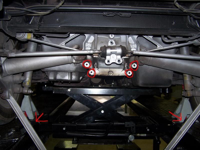

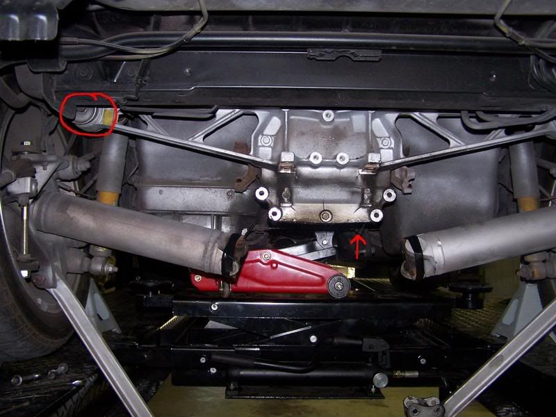

You are ready to unbolt and remove the housing. Support the transmission/ rearend mount with a jackstand. This is important as this brace holds the trans up and you will not be able to remove the rearend without it supported. There are 4 bolts to this part. The side ones are 18mm on the bolt and 3/4 on the nut. The big suckers are 13/16 bolt and 22mm nut. (I think
I didn't get a picture of the big bolts so look at the second picture to see where they go. The rearend is out now and you can see the bracket.
