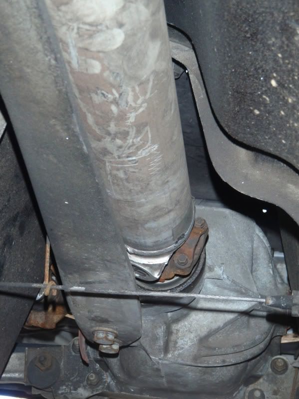

The next step is to remove the driveshaft. Do this by disconnecting it from the rear end. You will need to remove "4" 8mm bolts and then you can pull it out gently from the transmission. Before you remove it though, be sure to mark the driveshaft and rear end with a line for easier installation. Also, you imight want to tape up or use rubberbands to keep the "spiders" from falling out of the spicer, its a pain to reassemble if you do drop them, so be careful.
Now the driveshaft is out.

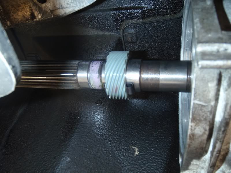

Now, looking through the hole that the driven gear just came out of, we can see the red drive gear that we need to replace next.
To get to the drive gear, we need to remove the tailshaft housing which is held on by 4 bolts. In order to get to the top passenger side bolt, the C-beam needs to be moved. Remove the two bolts that hold on the C-beam up front and only one bolt that holds it on in the back. This will let you slide it to the side without completely removing it, as you can see to the right of the picture below.
Remove the red drive gear by lightly tapping it with a hammer and chisel to shatter it, just be sure not to lose the clip that holds it on, because you will need it to attach the new gear.
