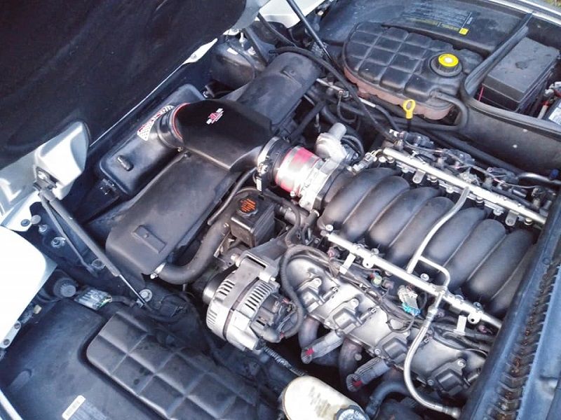

Back on task, right now I need to correct my ram air setup. There were some subtle changes made over the C5's life. the 2001-2004 cars used a larger diameter mass air flow sensor. I upgraded to this sensor but because my vararam ram air kit is for 1997-2000 I had to dump the vararam air bridge or 'powerduct' and run a factory part from 2001-2004. Here is what that looked like..
So now that I have been to the track a fistful of times and made a bunch of passes each time I am ready to start chasing power with my C5. First up I must correct this intake setup. I ordered the 2001-2004 C5 powerduct from vararam and it came in. But while I am installing it I need to make a careful modification to the 2001-2004 MAF I am running in my C5.
While I was at the dragstrip this last time as I was getting ready to race I jumped out of my car and raised my hood and removed my engine's air filter. My racing buddy was laughing at me while giving me a thumbs up. And my times were identical and I do mean Identical to what they were before. Absolutely no change. And I want to show you guys why that is. This MAF right here was designed around a 5.7L engine making 350hp at the flywheel:
Yes that screen has caught some debris and to the untrained eye that might seem to be a good thing but I am here to tell you that there is no metallic items caught up in that screen, All of it would have passed right through the big > 2" valves and all of it is only an ever worsening restriction that limits how much air can make it to the engine. So I removed the screen altogether..
And with the right powerduct the MAF is also installed closer to the engine. This most definitely requires tuning and I am doing that on the streets tonight. Here I am all setup with the de-screened MAF and the correct 01-04 powerduct installed..

Good luck with the tuning. We've been descreening the LT1/LT4 Mafs for years and very few, if any, tuners have been able to get it right. I'm not a tuner so Idon't know the problem but apparently it has something to do with how the air flows through the MAF differently at varying engine speeds. Mine was so bad I put the screen back in.:laughing:
4,728 Posts
Discussion Starter #231
Ya that's why I left mine in as long as possible. That screen evens out the airflow and smooths the signal coming from the MAF. What's worse is I also moved the MAF really close to the T.B. which will play hell with idling because there is no iac so the idle circuit just opens the t.b. a few % and the idle air comes from the very top and bottom of the intake tube and that airflow doesn't get seen by the sensing element in the center of the MAF tube.
But I got it running good last night and later this week I have a fuel supply upgrade to install and then I will put it on the dyno and see what that was worth. And hopefully this Friday or next we will get to find out what that was worth getting down the 1320.
