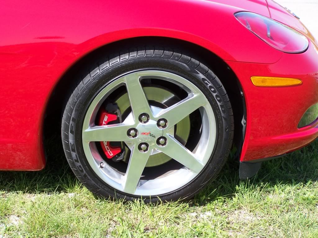

You can get them powder coated from thepowdercoater.com. You can send him your calipers and brackets and he will turn them around in about 2 days, or you can put your name on the list. When your name comes up he will send you calipers and brackets, and then you send him yours for the next guy. Cost is $230 for the coating and shipping. More than painting, but they look better and are more durable.

There is a pic on Mike's website of what you are looking for. www.thepowdercoater.com

Great work! But like steven said, More than painting. But you never have to repaint again, the color will stay.
