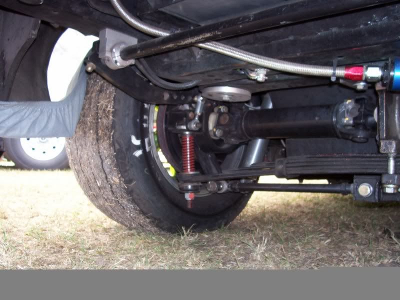

looks good...but I must have missed the earlier thread. What does those little coil springs do around the bolt? Never seen nor heard of them before.

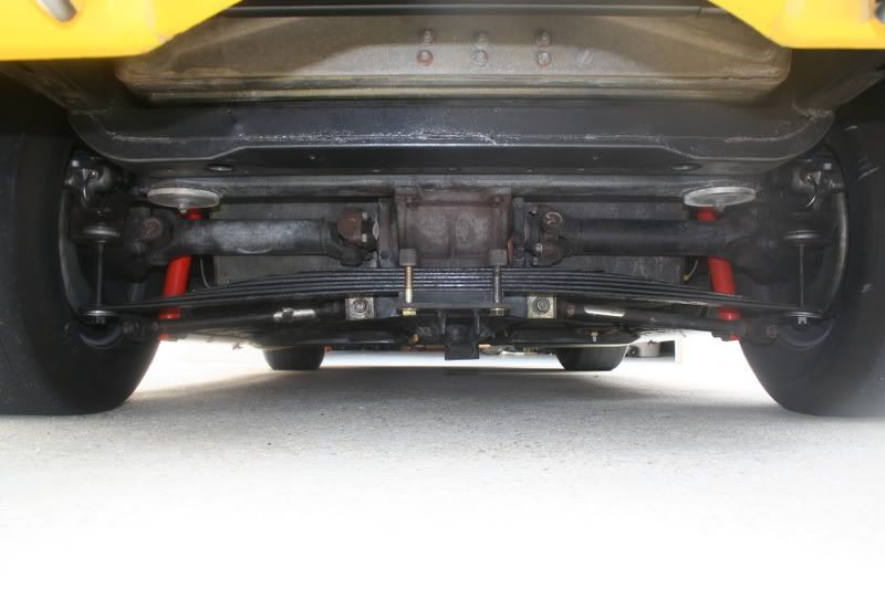

Took me less than 20 minutes to drop the whole rear end out... Much better approach. Replace the nuts bolts and washers with new. 30 year old critical fasteners are nothing to be racing with.
You can use a hole saw inthe rear deck to get after the 4 bolts that hold the diff to the crossmember and it is even easier.

are those coil springs necessary because he lowered it or plans to race it? I know I have some free tension on the bolts when the car is jacked up...but its only like 1" on both sides and I am running 8" bolts also fully extended as my car is nice and low also. So does this function in the event the rear suspension should suddenly drop all the way to the bottom such as with a pot hole or maybe a very hard corner where the inner wheel would be extended?

Not required at all
It just keeps the spring in place and hopefully it help it more predictable
It would make the suspension stay more consistent instead of the spring flapping up and down when going over bumps

think about a piece of tubing with some large OD washers welded to the ends or a piece of solid plastic with a hole bored through the center....

Exactly, just like a proper sway bar setup (well, proper given the use of bushings instead of rod ends), 2 washers and a sleeve or simply an extra nut, washer and cushion on some longer bolt like I did for a buddy, retains height adjustability without having to change sleeve length.

I got 2 inch longer bolts
Went up a size to 5/8 also
They are only grade 5 though
Do you think I need grade 8? I think grade 5 5/8 is plenty strong enough
