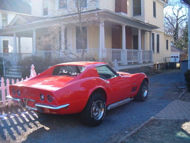

huh. I hadn't heard of them until just now. I'm really happy with the VB&P spring. I uploaded some pics from my installation. They show what the suspension looks like unloaded with the 8" bolts.Corvette America. It was a TRW. I called TRW about it and the guy (Justin) that I spoke to was a major jerk! He told me there must be something wrong with the car or else I had done something to screw up the suspension. I don't believe I'll be buying any TRW products if I can help it! Art
