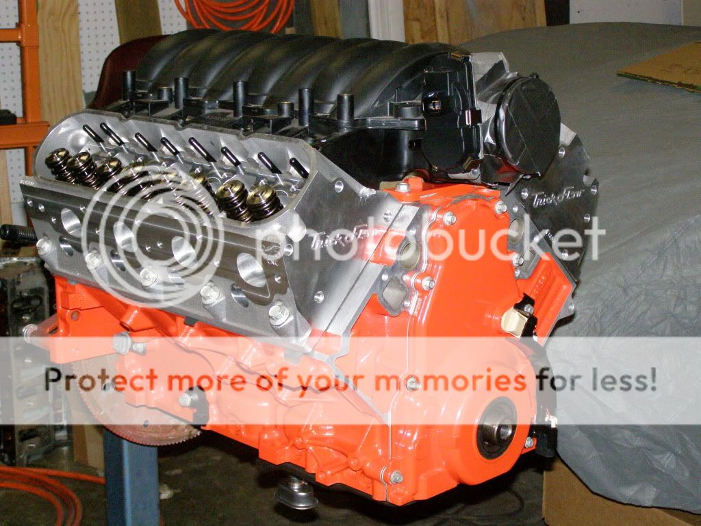

I get about 5 minutes every six days to work on this, so this has been a very slow project. I hope to complete the motor in the days to come and get my trans ordered from monster transmission this week if I can find a few minutes to do so. I am hoping to drop it into the vette in a couple of weeks but I will have to drop a few other projects to make that happen, to many things going on in my world right now.
Here's a little teaser of the LS2, I will post some details here soon.

That's awesome. :thumbsup: I haven't seen very many LS engines dressed in orange, and as usual the aluminum heads look fantastic on it.

Some details, I bought this LS2 last fall. It's from a 2008 SS Trail Blazer with only 6,800 miles on it. These motors come from the factory with about 400 HP which is great, but I can't leave well enough alone so I wanted 500+ HP. Let me start out by saying this swap is already beyond my original budget, But if I receive the performance and reliability that I am expecting from this LS swap, It will be worth it.
Here are some of the parts that I have to this date,
Trick Flow Specialties TFS-K306-550-470 - Trick Flow® 550 HP GenX® Top-End Engine Kits for GM LS2
http://www.trickflow.com/partdetail.asp?part=TFS-K306-550-470&autoview=sku
Heads, cam, rockers, push rods, head gaskets, head bolts, crank bolt,
Trick flow double roller timing chain
46# fast fuel injectors
Professional performance fuel rail kit
LS2 Corvette intake/ I might be swapping it out for the Fast LSX manifold,
Just don't know if there is enough HP gain for so much money.
Vette Aid Long tube headers
F body oil pan
I hope to get to finish the rest of the motor by the end of the weekend. I will be ordering a new 4L65E from monster trans this week I hope, and once I have a final dissection on it it well be time to send off my harness and Ecm to either Current performance or to spear tech. Once I have the harness back onto the motor I will be dropping it into the car.
I have so much going on for the next few months I believe there will be some
delays in getting this finished as fast as I would like to see it get done.
Look for more photo's here soon
Riggs.

I really haven't had time to make any progress this weekend other than doing some more detailing on the used parts to be reinstalled
Here are a few more photo's
Trick Flow head and cam kit for LS2. Old cam shown in photo, got ahead of myself before I remembered to take some photo's. The timing chain was bought separate.
Double roller timing chain. I order to use one of these you most clearance the timing cover. With the new timing chain assembly it spaces the oil pump out by like 3/16'' making the cover rest on the oil pump mounting bolts and part of the pump.
Fuel rails to feed the new fast 46# injectors
F body oil pan
Ceramic coated 1 3/4'' headers for LS C3 swap
More photo's to come soon.
