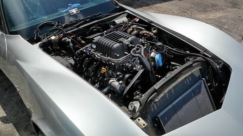

This car was in ruff shape when it came to us. There were substantial problems with all that had been done with the conversion up to the point where it came to us. And I actually forget if he didn't like our price to tear everything out and start over or if the owner of VetteXperts backed away from the job.
If memory serves I think this car had a 6L80E mated to the LSA and they didn't cut the floors and modified the crossmember to let the tailshaft hang real low putting the driveshaft at a very stupid angle. If you look at the picture you can see the angle of the engine. I think we were suggesting to remove the powertrain and gut the interior for floor modifications so the powertrain could be mounted in a more friendly way to the driveshaft.
I was ready to jump all over this back in that day. I would have made this a real machine. But it just didn't solidify.
