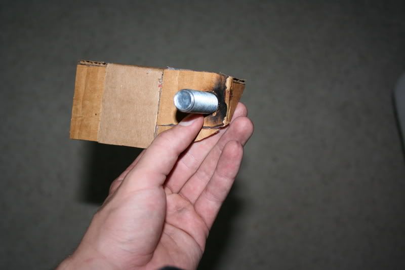

I decided to make them out of cardboard.

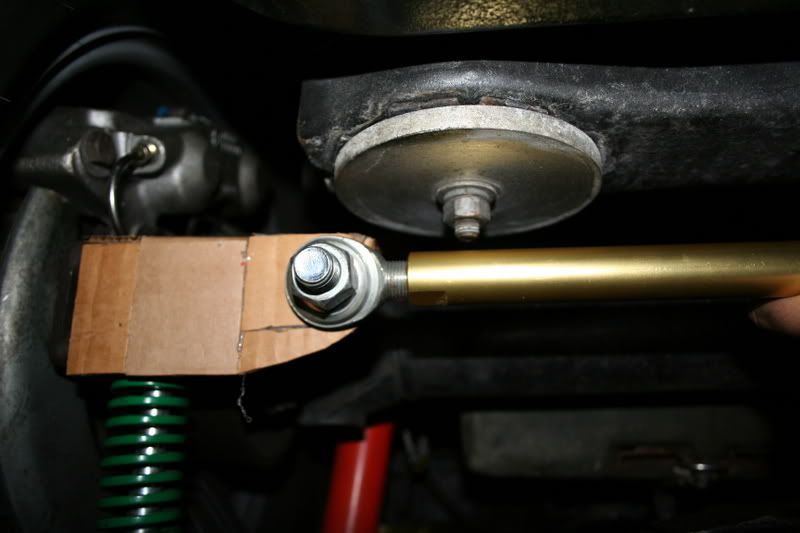

I need to trim a bit of the left side. The top is flat also. I forgot to get that in the pic.
Would you recommend anything else?
What thickness of steel would you recommend?
I have a problem though, the rod wants to hit the bolt so I have to scoot it out about .5". I'll draw something on paint.

Heres the problem. I was thinking I could just raise the diff and raise the adjustment bolts.
The drawling would get an f in drafting class but It's good enough :laughing:
Blue is the TA, red is the bracket
I don't think it needs to be too strong becuase all it is doing is supporting it. 3/16 steel should be sufficient. For the bend over I would just bend the steel 90* instead of welding. Adding gussets to the back off course and lightening holes :laughing:
I could also add another part for the bolt to go through to reduce the shear.

Isnt that bracket mounted to high? Will hit the xmember long before you get full compression...
Take the spring bolt loose and use a jack to move the mockup through the entire suspension travel....

Yes it will hit. Thats Why I want to raise the diff and then crank the adjustment bolts up for get a higher arched spring.
I don't know how much travel I will use yet. After the adjustments it will hit the bump stop Before the rod hits.
Maybe I should just not worry about it. It was just something to do that was cheap.

You were just looking for a 5 leaf and a flat spring. My suggestion to you is to do one simple thing that will help and you have all the components already
Space the strut rod bracket down until it is parallel with the half shaft!! then set your rear camber to just a bit negative and set your halfshafts to droop just slightly so that when your on the gas they go flat.
Make sure you let the suspension settle by driving up and down the driveway once !!
Then STOP farting around.... :thumbsup: :rolling:

I thought that TT said that the smart strut bracket doesn't help.
I would have to raise the car to get the half shafts parallel.
