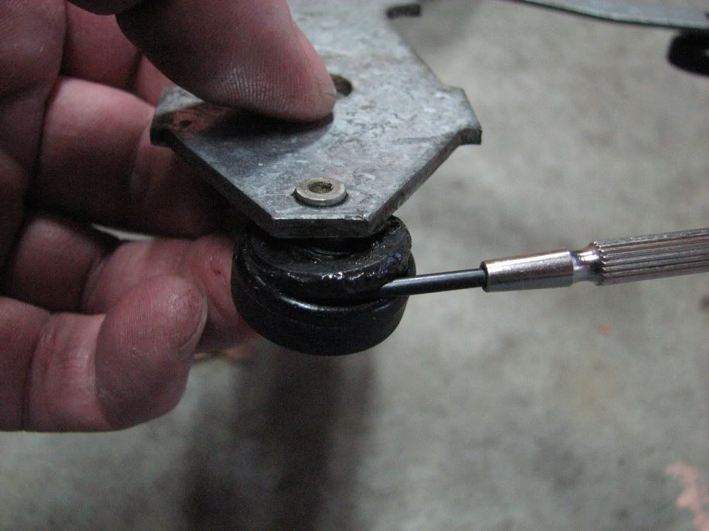

prying off the back:

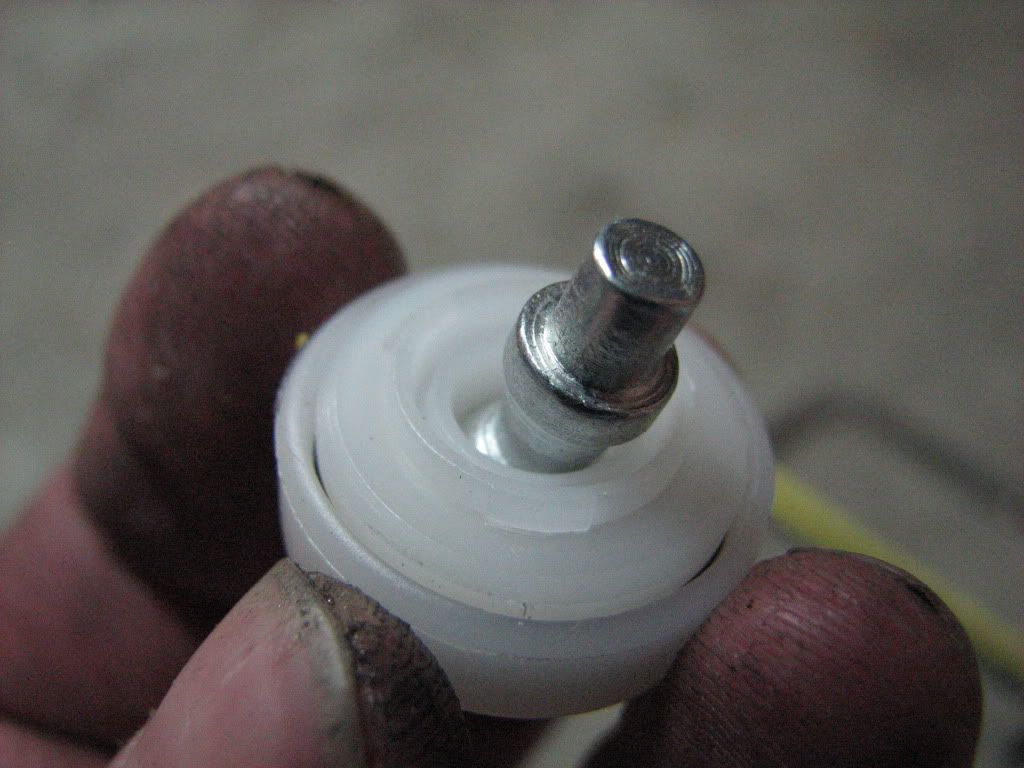

the new roller front:
roller back:

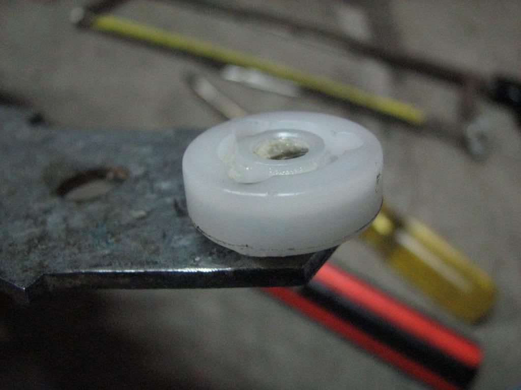

prying the new back off:

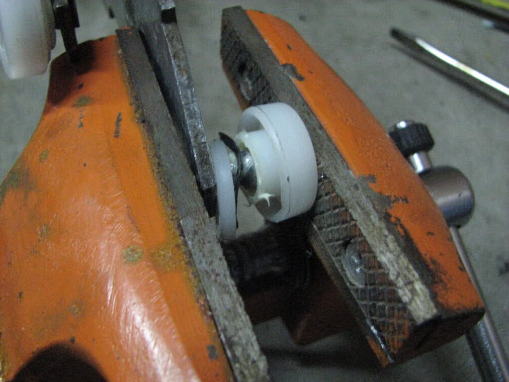

pushing out the new post from the new roller with a bolt and a 5/8" socket in my vise:
after:
roller back:
after:
