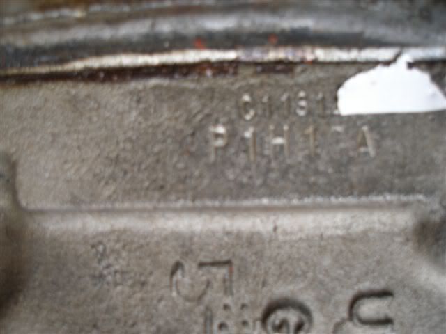

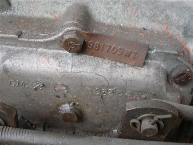

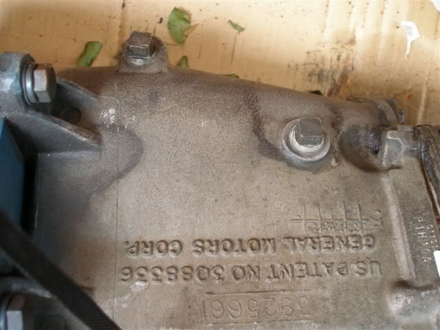

I have a muncie 4 speed off a 71 Corvette it appears to be the
original one that came with the car with a FINE SPLINE INPUT SHAFT WITH
2 GROOVES, which I thought may be a M22 , but according to the stampings
on the side of the rear flange
The last letter "A" means it's a M20 if its supposed to be the last
letter
The numbers are as follows
Car is built on 22nd June 71 - K22
C11S120xxxx - vin matches
P1H10A OR P1H1CA - Hard to read O or C , P= Place of manufacture,1= 71
model, H1 then C= M22 June 1 OR H10 = June 10 & M20
Small Tag under bolt on shift side plate=3981709WT
Casting Main Body = 3925661
Tailhousing = 3978764
Every other M20 I've had ON 68,s & 69,s I'm almost sure had a coarse
spline input shaft ,
Any Information would be appreciated
Rgds John Y
