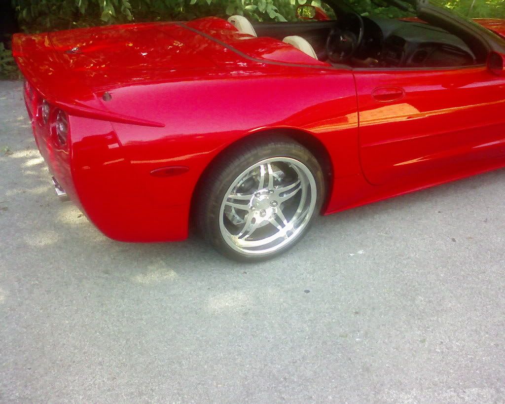

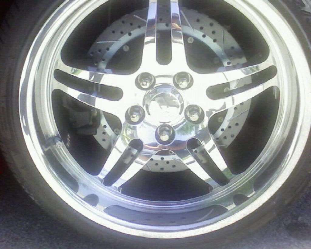

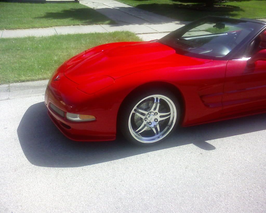

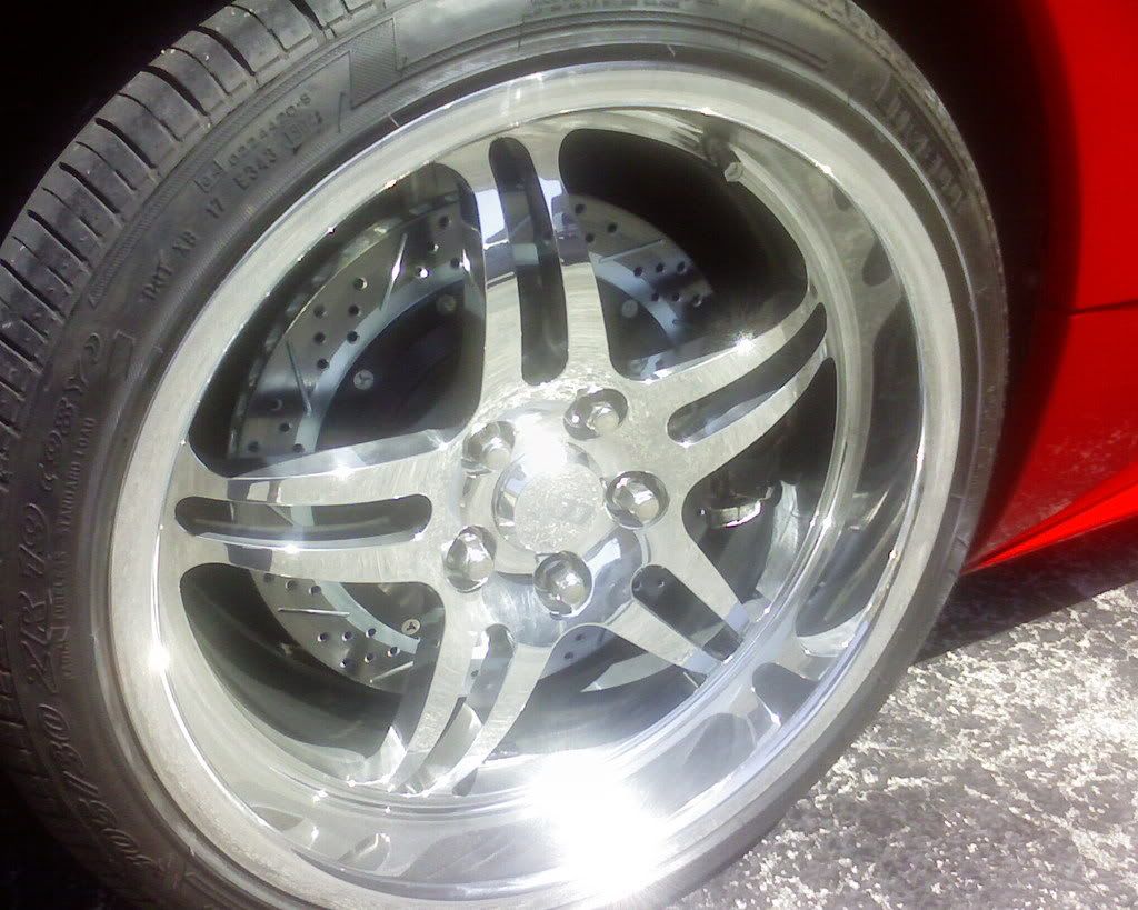

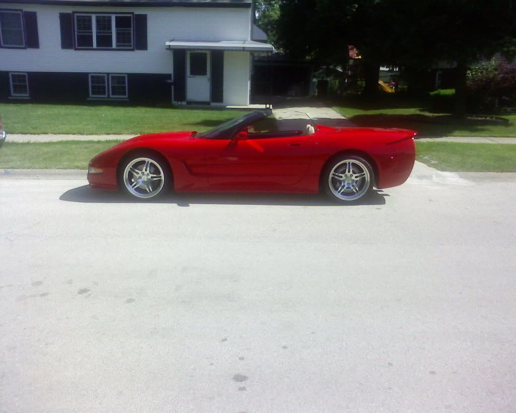

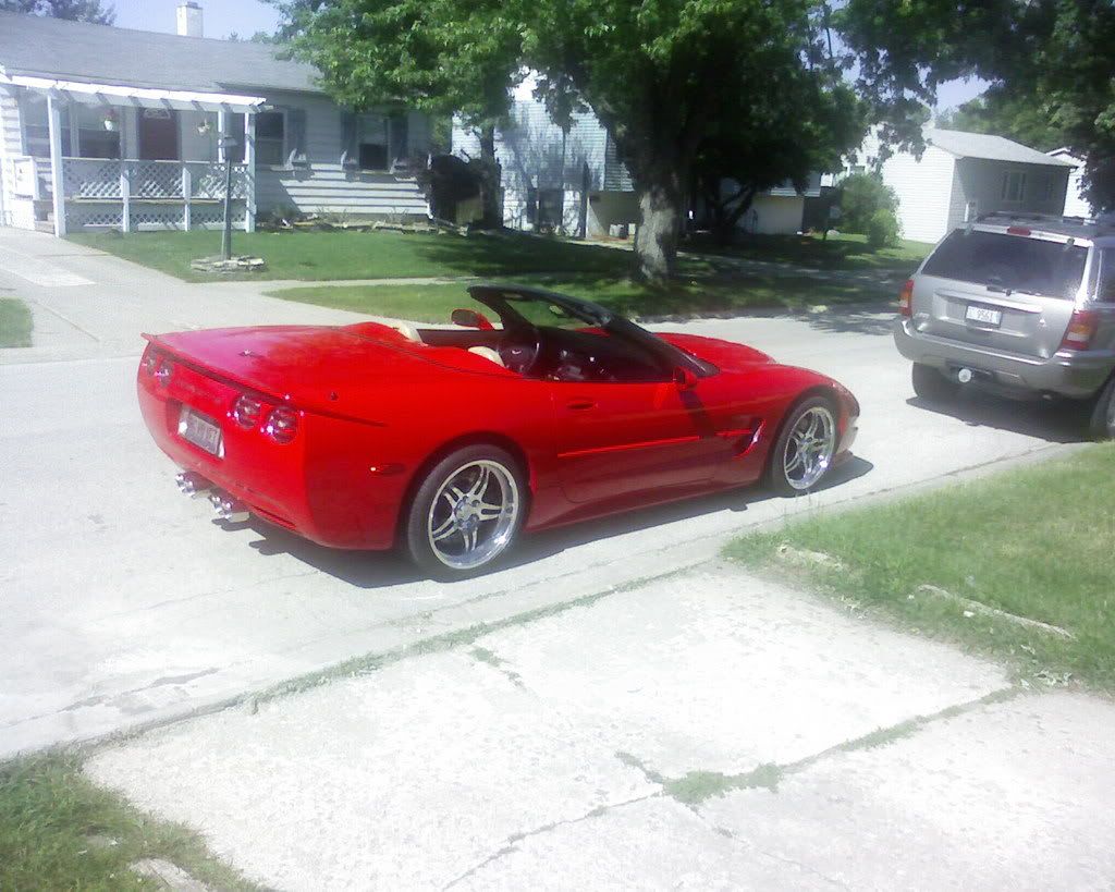

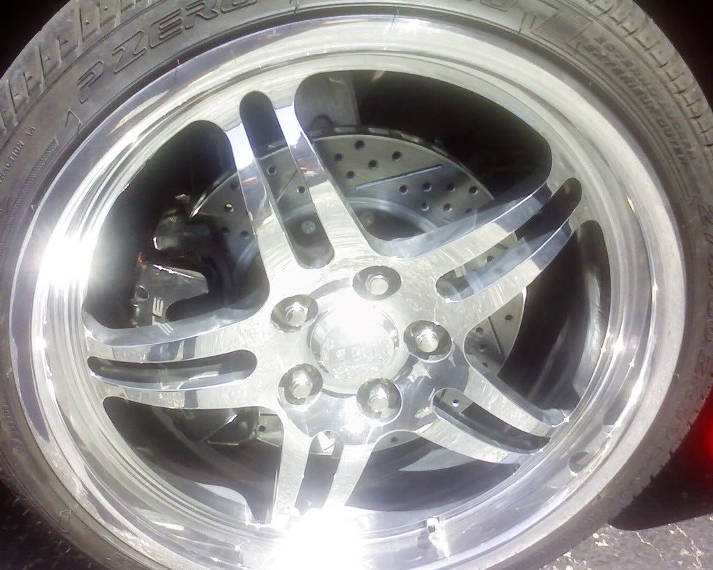

installed eradispeed +2 rotors ss lines hawk pads:devil: ( if anyone is thinking about these rotors that have ccw's you NEED a spacer and longer studs)
also on the way: cam, heads, 90/90, oil pump, push rods ,timing chain, rebilt trans, torque conveter, springs:devil: :devil: and maby some other things

eh we were going to buy the gm painted ones but (i think) 400 dollars is a bit to high but if we were to get them in red we wouldnt paint them
4,479 Posts
Discussion Starter · #7 ·
they dont leave any paint lines ?
do you have to sand down the rotors first?
im shure it would look nice but i dont want to have to go through all the trouble of sanding painting and making shure i dont get any on the corvette letters

I've got the same rotors, and I love em! They look great on your ride!

You can scuff sand them, but brake cleaner is really all you need. For the letters, you simply use a razor blade to take the paint off of the face (when the paint is dry but still soft). The end result is stunning, and the effort to do it is minimal.
well i think the modding is done for a little while but ill consider the idea it does seem like it would be much cheaper
