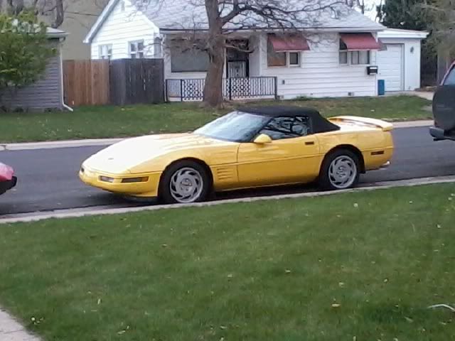

Picked up a 91 convertable the other day. Paint is not that great but still looks decent, top has a few minor holes in it yet still looks nice, interior is in great shape. Yet the stereo and speakers have been replaced with an after market brands. Whomever did the install on it hacked all the wires. I replaced the stereo with a much nicer one as well as the speakers. Having trouble finding the wire for the antenna to work. Can anyone help me in locating the correct wire for the antenna? Other than that it runs great. Took it on a trip up in the mountains, 200 mile round trip and it did great.

Antenna wire is pink.
The original location: It is one of 4 wires in a black plastic plug that is inserted into the original tuner.
Tuner location: Behind the fuse panel. Remove the hush panel under the right side of the dash. Remove the fuse panel cover.
Remove the 3 screws securing the fuse panel sorround & peal the dash carpet back.
If the original tuner is still in the car the plug will be on the right side near the back of the tuner.
The other wires besides the pink antenna wire are:
Orange = radio memory
White = keyed on, off.
black = grounds.

Ah, thanks for the info. Orange, white and black I got figured out. Could not find the pink one, but will take a look today and see what I can find.
