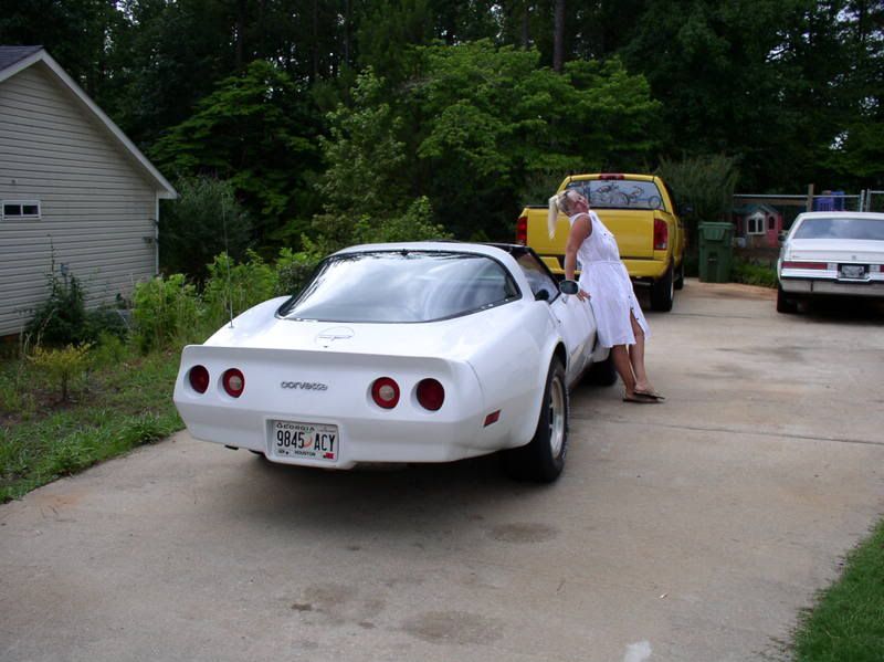

From the search it looks like you guys like Dr. Rebuild (weatherstriping)
Thread was a couple of years old, so is he still good?
Also will need carpet, door panels...
It's got a replacement engine in 92 (L48) but valve covers are brown???
I know it's not a tire smoker, but it's for the wife and makes her happy :thumbsup:

Congrats to the lucky lady:cheers:

Those valve covers are the magnesium 84-86 C4 perimeter bolt valve covers, that same cover later changed to centerbolt style. They are very nice if you clean them up. If the engine came with those covers you may have an 84-86 engine. All are 2pc main seal engines, flat tappet cams. The 84 is actually the most desireably as it has 464664 L82 TRW forged pistons, the later does not. If it is one of those years of engines it should have 462624 heads, a pass side dipstick (can only see your tranny dispstick in the pic) and the block should be 14810207

Welcome to DC...
My car was in roughly the same condition as yours when I purchased it 2 months ago. I've spent every waking (non-working) hour cleaning, scrubbing, buffing, waxing, and detailing.
That car just needs a little LOVE !!! Some cleaners, a little semi-flat black trim paint, and a high speed polisher and you'll be all set !!
Dip stick is on the right side, just back from picking up tune-up stuff, vac lines,etc...Wife said time to go to work.
