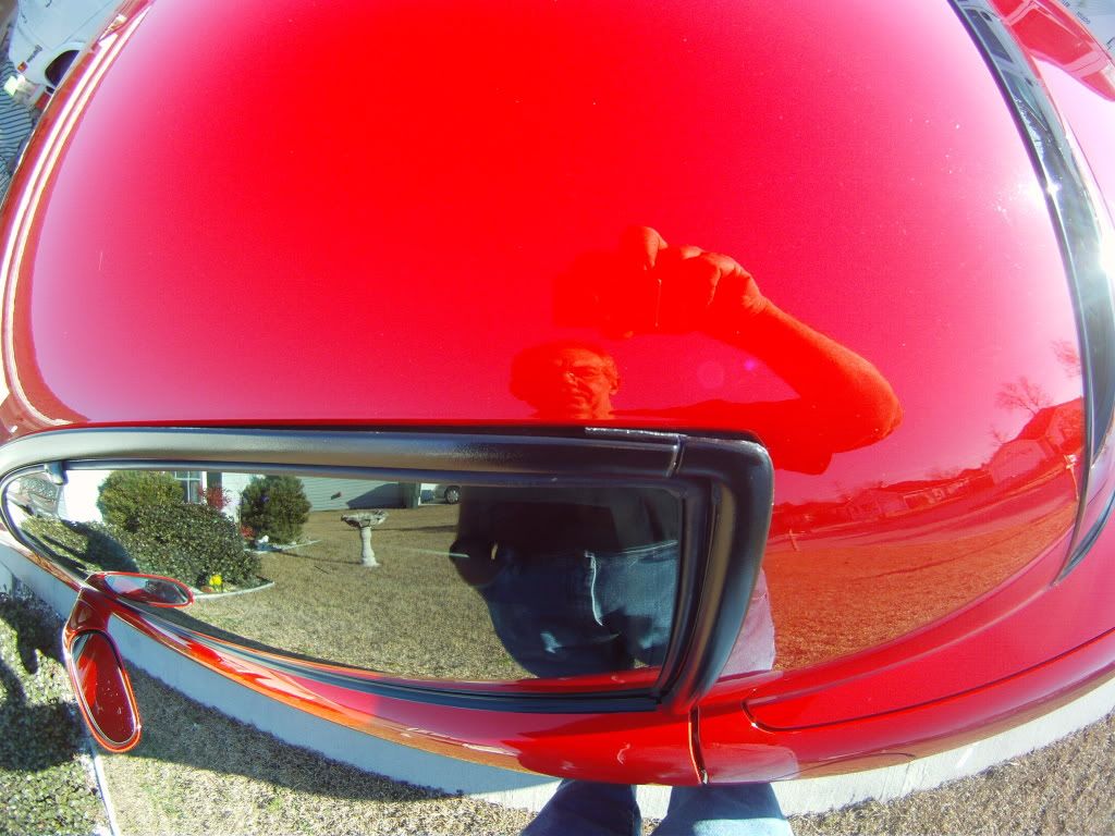

First, sorry about the fisheye photos, took these with my GoPro. Anyway, the rain gutter on the drivers side of my FRC is not seated properly. There are screwdriver marks where someone tried to re-seat it. I have pushed on it and it feels solid. it wont move. Anyone got the procedure for a proper fix ?
Drivers side, notice the gap.
Passenger side, smooth and flush.
Thanks in advance.

There are screws that hold the weatherstripping and gutter to the car. You have to first remove the gutter and inspect the weatherstripping. I suspect that the weatherstripping has come loose from the car and is bowing out, which is causing the gutter to bow out also. Have you removed the gutter to inspect the weatherstripping?

Thanks Junk, no I haven't removed the gutter. I didn't know whether there are special tools required or how it came apart. I didn't want to just rip into it and mess something up. I'll look at it again this weekend. Like I said, when I push on it it's solid, no give whatsoever.

I actually explained it backwards as to what I actually meant. The gutter is attached to the car and the weatherstripping is attached to the gutter. Something may be behind the gutter. You may end up destroying the weatherstripping if you try to remove it.

Yes, after reviewing the procedure, I'll probably wait until I have a new weatherstrip in hand. But, I do want to thank you again for the help. :thumbsup:
