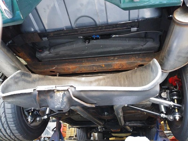

Now we need to make changes to the fuel supply circuit. With the FiTech unit the regulator was a part of the throttle body and we had 2 lines running from the gas tank all the way to the throttle body. Now that the regulator is separate I can put it where I feel it should be. Close to the gas tank. I am going to mount the regulator and also the fuel pressure sensor where the gas filter is currently mounted..
While those 3 clamps are holding the filter securely I will need to create a more robust mounting solution to hold the adjustable fuel pressure regulator and fuel pressure sensor and its manifold. Also this car will not need a filter anymore. The thing about FAST fuel injectors is they don't have filter baskets. and they have large pintles for the higher flowrates for the larger hp applications they are made for and also ethanol. So as a rule of thumb with these larger injectors if it will make it past the sock in the tank it will blow through the injector. And a filter is just a restriction at higher flowrates. So here is the bracket we made and painted and the assembled regulator with pressure sensor..
Here is the new return line just to illustrate how short the return path back to the tank is..
And here is the assembly mounted to the outside rear wall of the interior. almost directly behind the rear interior light fixture..
And now I can set the fuel pressure to 35, 43, 58, or whatever psi I want. adjustments are easily made with the spare tire removed..
