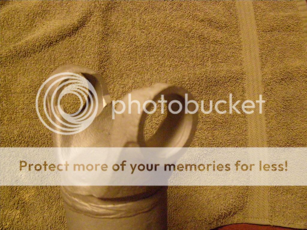

After blasting everything clean I found the old half shafts to be worn on the ends, as if they had been binding at some point.

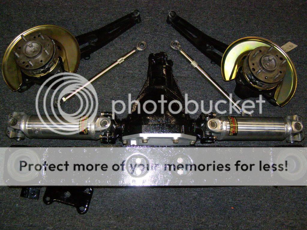

A local friend of mine rebuilt my trailing arm assembly's for me in trade for my old trailing arm, not a bad trade.

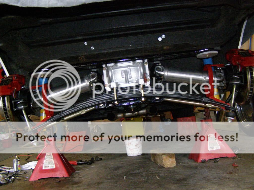

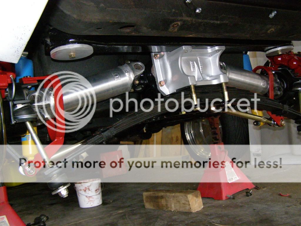

New 3'' aluminum Denny half shafts, rebuilt trailing arms, and freshly painted parts.
New slotted cross drilled rotors on all for corners.
The E brake cable has been relocated to the top of the trailing arm since this photo.
And now some shots of the completed set up.
I still need to install my stainless brake lines front and rear and bleed the brakes and do an alignment . On a side note, I will probably be had a hydro boost setup to the car during My LS swap so I will wait to bleed the brake until then.
